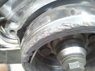

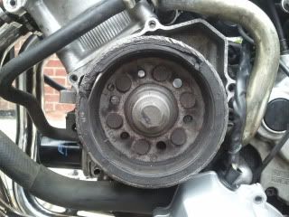

I will get some pictures of the damaged parts on wednesday or thursday and post them up see if anybody would say they are the faultEvilchicken0 wrote:I've tried to fit a geny from a 4JH to a 3TJ engine the wires are in the worng place and the casing is slightly different.

i think ive got the casing off a 600 that someone gave me, not sure if the stator is in it but i'll check when ive seen the pic!

Ok so managed to get pics of the parts yesturday but had to go do a few jobs so not managed to post.
Here is the pic of damage to the rotor, (inside casing)
And here is the damage to the MASSIVE magnet (connected to motor)
Any body know if these would stop the bike starting??
