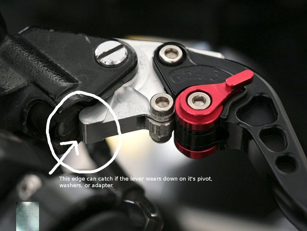

Honda brake levers, it turns out, have two fittings. On the NC30, the adjustable brake lever requires an adapter to maintain it's position within the brake perch. No problem, a couple of washers would do as a temp. solution, and Ricoh supplied an Al. adapter when I picked up the passenger foot rests. The trouble was, there's a discrepancy between the shape of the lever adapter where it should touch, and therefore turn-off, the rear brake light switch. And here we come to a further difference. Most Honda brake perches include some level of adjustment so that the brake light switch had be swivelled forward or back on it's mounting bolt. Not so with the NC30. In this case, the brake lever fitting requires an additional 2.57mm to activate the brake switch reliably. Note to self, how much will it cost to machine a new brake lever fitting, 2.5mm longer? (Thinks, if I go down this route, perhaps it could include a channel for a tiny bearing race...
Note to others: DANGER! Be very careful if you fit after-market levers which require an adapter or washers to attain the correct height on the brake pivot screw. The design is not fail-safe. Should your adapter wear with use, it's soft aluminum after all, it is possible the height of the brake lever could fall 1mm+ whereupon it may come into contact with the brake perch itself, rather than push the brake piston in the master cylinder. If this happens, you would have NO FRONT BRAKES. Of course, this sort of thing only happens at those high-G moments when you need the brakes most... Be careful out there.

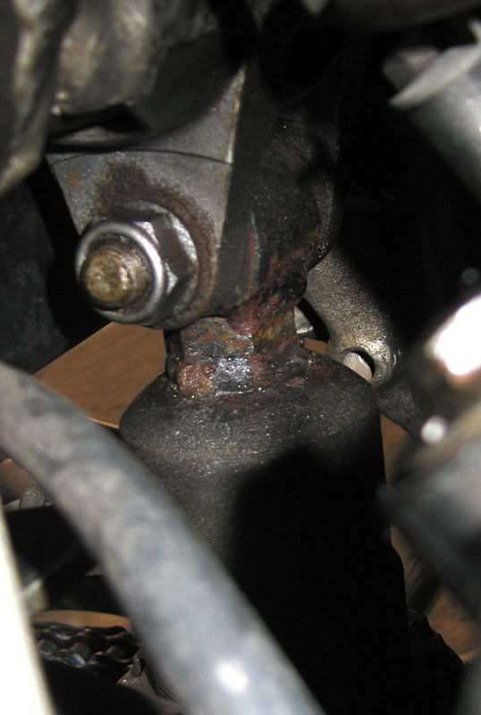

While liberally applying WD40 to the rear shock linkage bolts, I looked up and noticed the rear shock didn't look entirely standard. Compared it to some photos on eBay. Good news. The top bolt fitting has been cut and re-welded to add circa 10mm. Accounting for the rear suspension geometry, I believe that should add 35mm height to the rear. That saves a job.

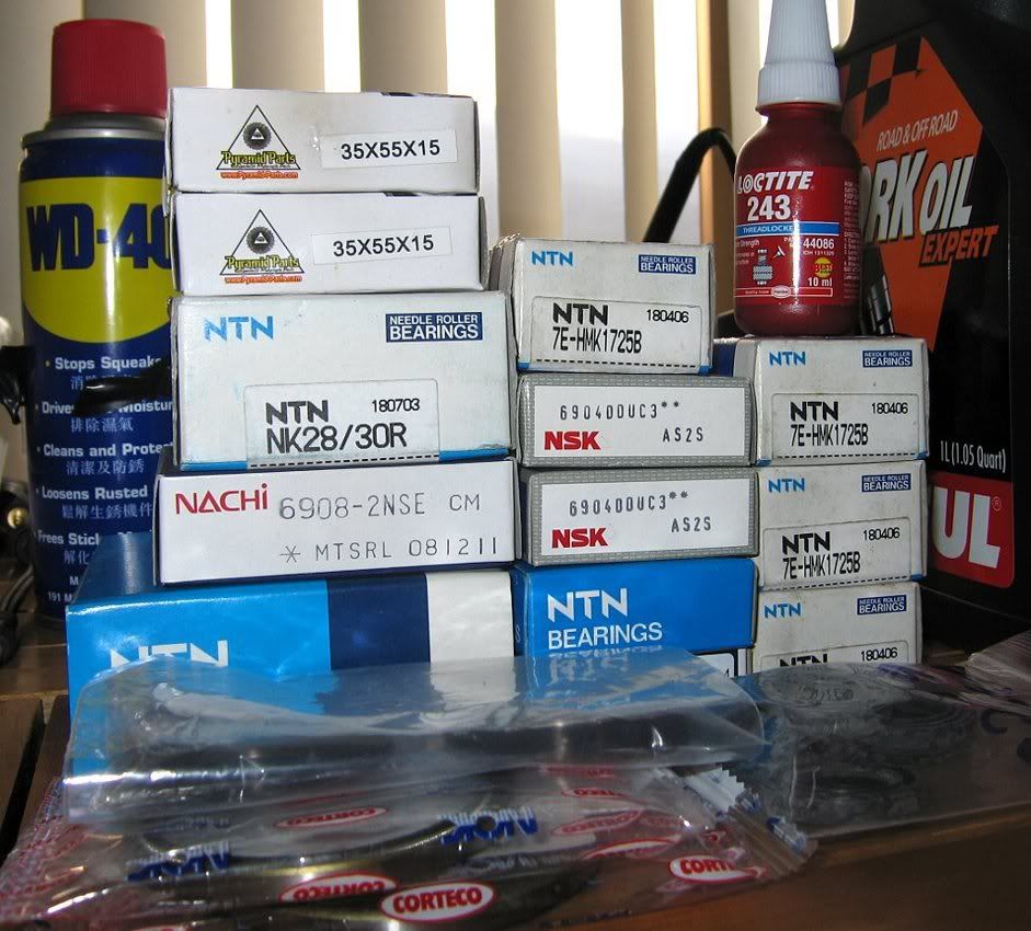

And, DHL delivered the first package of goodies mid-afternoon.

Impressive delivery, but WD40????
That can be bought at most shops here in Thailand mate :)
Loctite, i haven't seen that any where, rather worrying really when you considering how many shops build / repair bikes with out it :S
