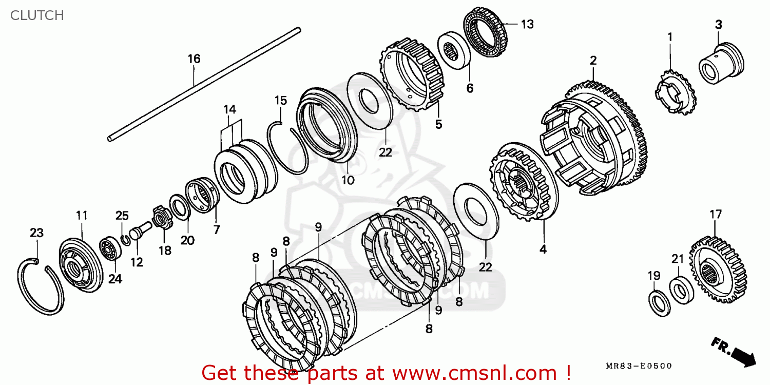

HOw many plates are in it then? It should be a bit of a pig to get the nut on...
a fiche is what you use to find out what parts are required for your bike - it is basically an exploded diagram of all the components etc.
Go and download the NC30 one from akhara.com
part 12 - this is the little piece that fits on the end of the slutch pushrod - it slots over the end and then fits into a bearing that then fits into the pressure plate.
I would take the clutch apart and do it again - get the right amount of plates in there, make sure all circliips are fitted too and take us a lot of pics. They are simple beasts and we'll sort it!!

http://images.cmsnl.com/img/partslists/ ... 0_4b75.gif
LARGE picture of the clutch fiche

I put the same amount of plates in each time. I can't recall how may are in there, but when i first replaced the friction pads, i did it one for one like in Declan's video tut.CMSMJ1 wrote:HOw many plates are in it then? It should be a bit of a pig to get the nut on...

Right, take it apart and took the following
I have 9 friction plates and 8 metal plate, I've compared all the parts and have everything on the finch and appears to be in the correct order.
SHould the basket be able to move backwards and forwards? - it moves about half an inch atm.
So is it now just a case of trying to put it all back together?
Thank's for the kind offer Chris but i start work at 5 so won't get much more done today but i maybe calling on you tomorrow if i cant get it sorted lol.
Cheers Gents
Russ
