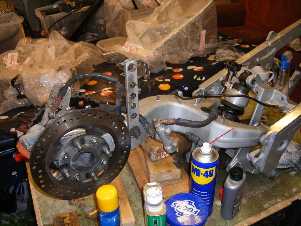

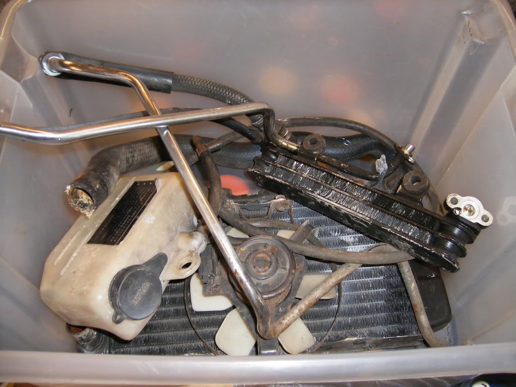

Another update folks. I've managed to get some pictures up so you can see what it all looks like.
the bike is all in bits in the boxes
frame being cleaned up

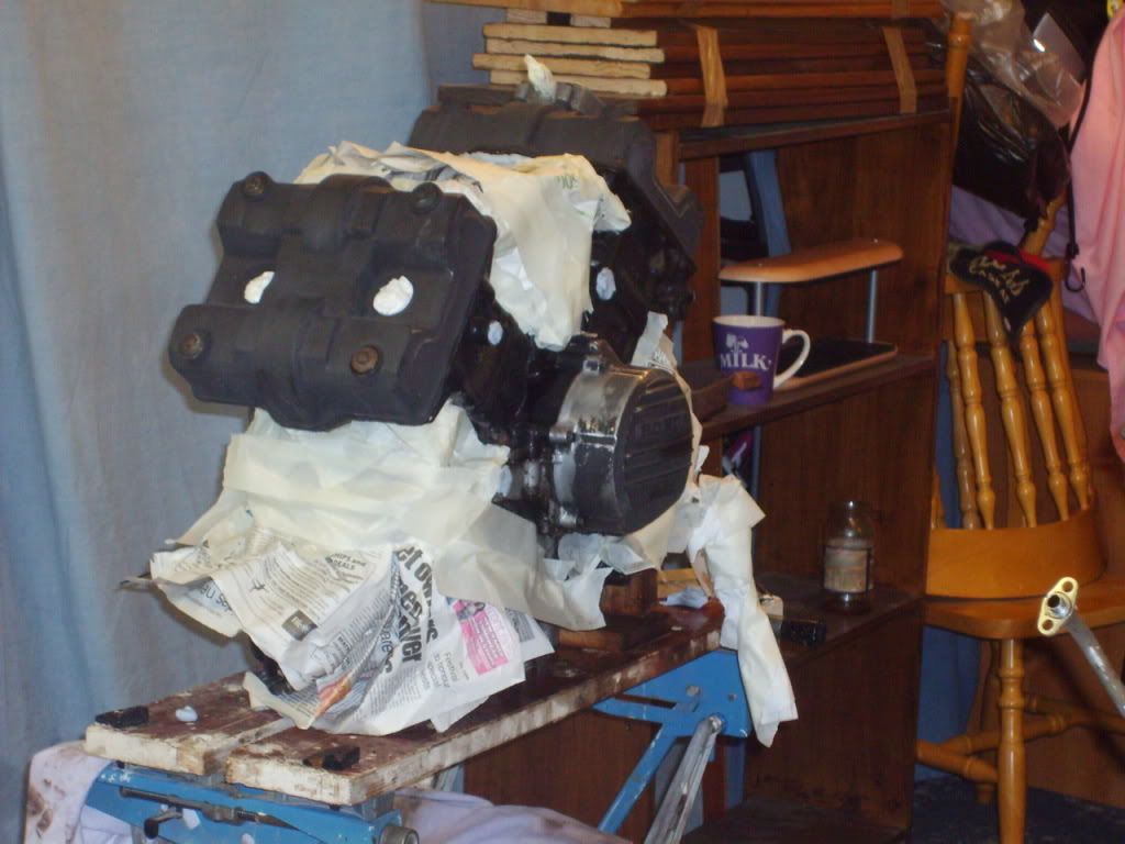

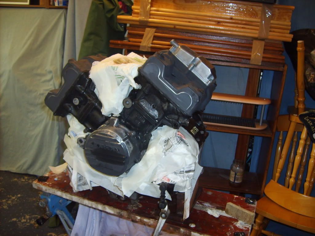

this weekend i managed to get the engine up on the work bench and get it degreased and cleaned.
the sprocket has a little surface rust but will most likely be replaced.
The engine now looks pretty clean :)
So now i masked it ready for painting

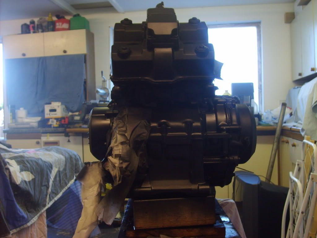

The engine was then sprayed with "fast black" satin black, High temperature paint.
