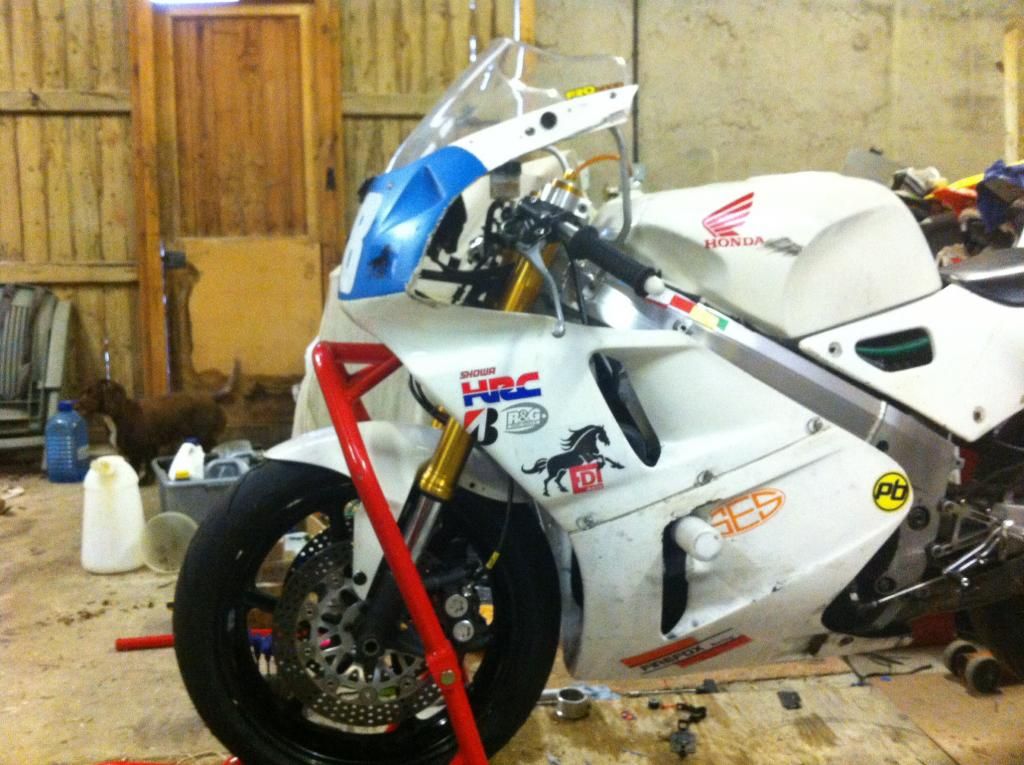

So, it's looking like spring is looming, which means race season is looming, thank god!
This year I am going to try and do as many rounds as I can before July, this is as we are expecting our first child on 4th July so I may have to pass on a couple rounds later on in the year.
Again I'll be with bemsee and it looks likely I'll be joined by my brother on his fzr 3tj. So it promises to be a fun year, however the first round is at brands Indy at the end of March, which leaves me a little short on time to get a couple trackdays in prior to the first race, and as I haven't ridden it since brands gp at the end of August 2014 I desperately need to get some laps in.
Last year before silverstone I'd done one trackday which I fell off during and then rode like a total lemon at silverstone and I'm keen not to repeat that this year.
So since I blew the engine up I've had a bit of work to get it all back together and ready to roll, so in the space of 2 weeks we have gone from this
To this
winter has seen some upgrades
675 front end
R6 radial calipers and m/c
Fully refreshed and rebuilt engine
Running a standard airbox and filter with the hrc setup ditching the open carbs showed no loss on the dyno and the filter will prolong the life of the valves and rings
