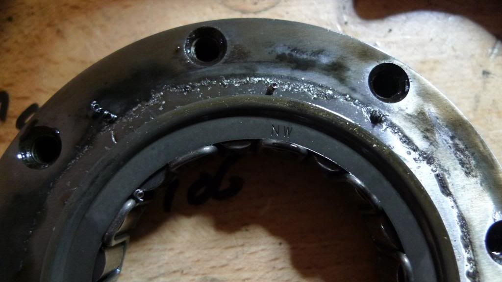

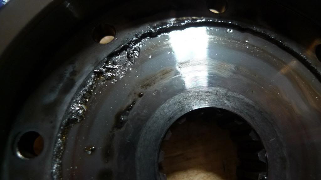

Talking of 999's, one reason for slow progress here was prep on other bikes for a 9 day ride around Tasmania. But after three days of 'holiday' my starter sprag ate itself ... so another reason for slow progress. The holiday was cut to three days and I brought the bike home to start tearing it down. At this house 'road beats track' so the road bikes always get priority'. Anyways, check this out .. you can almost hear the cash register going ching-ching:

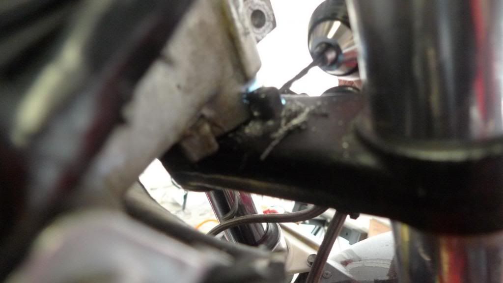

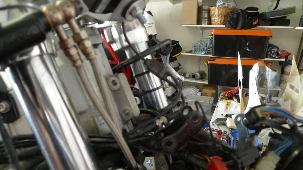

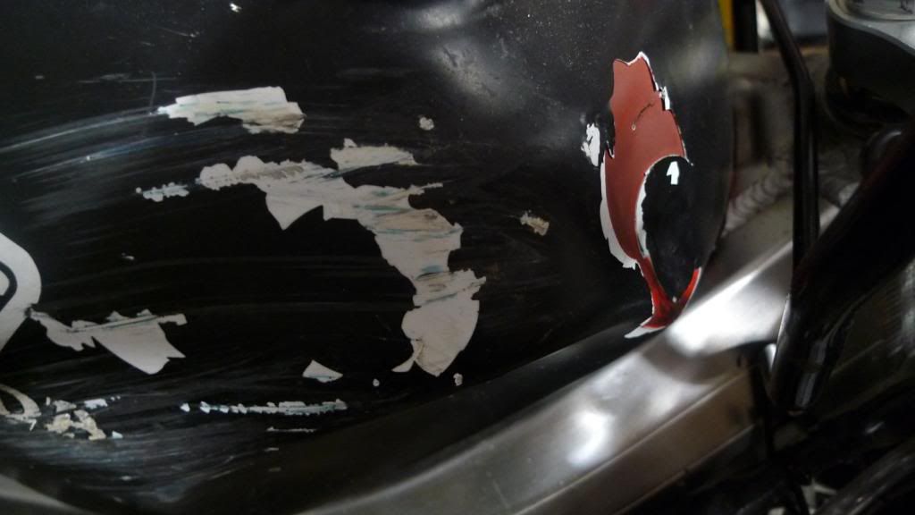

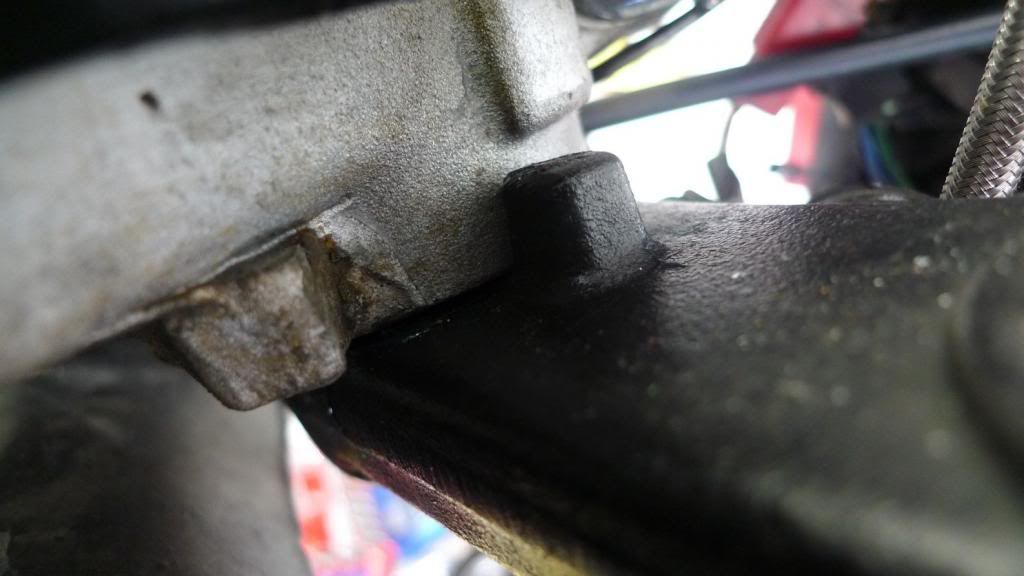

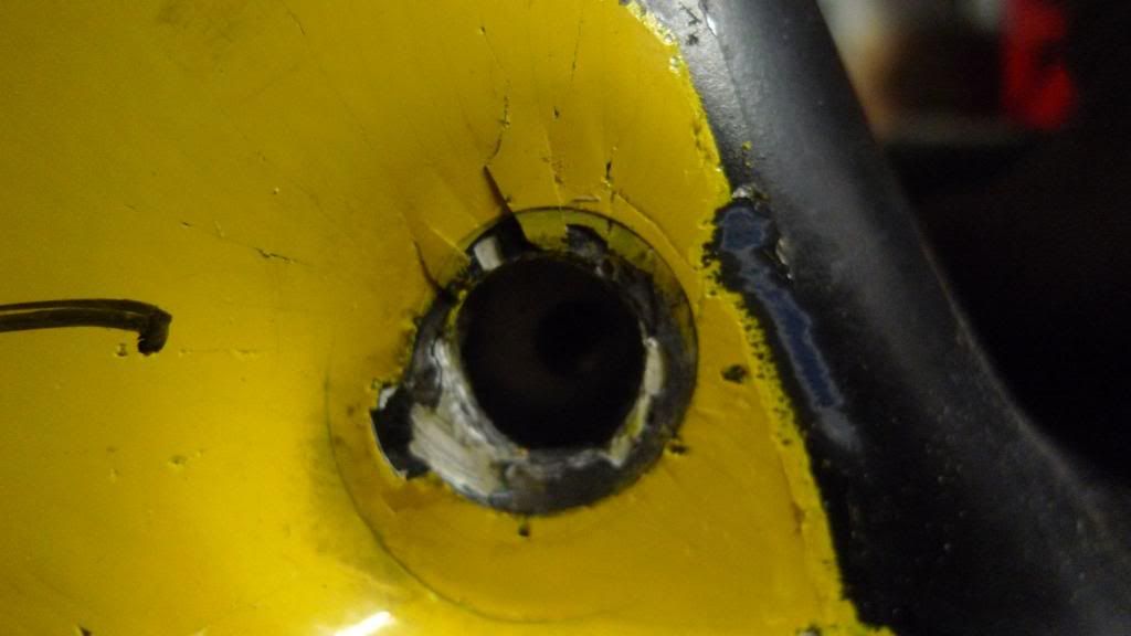

This sux also :
The steering lock tabs on the triple clamps don't actually stop the 'bars from smacking into stuff. Nice one. In the crash, they turned enough to dent the tank and the frame. Yeah, nice one.

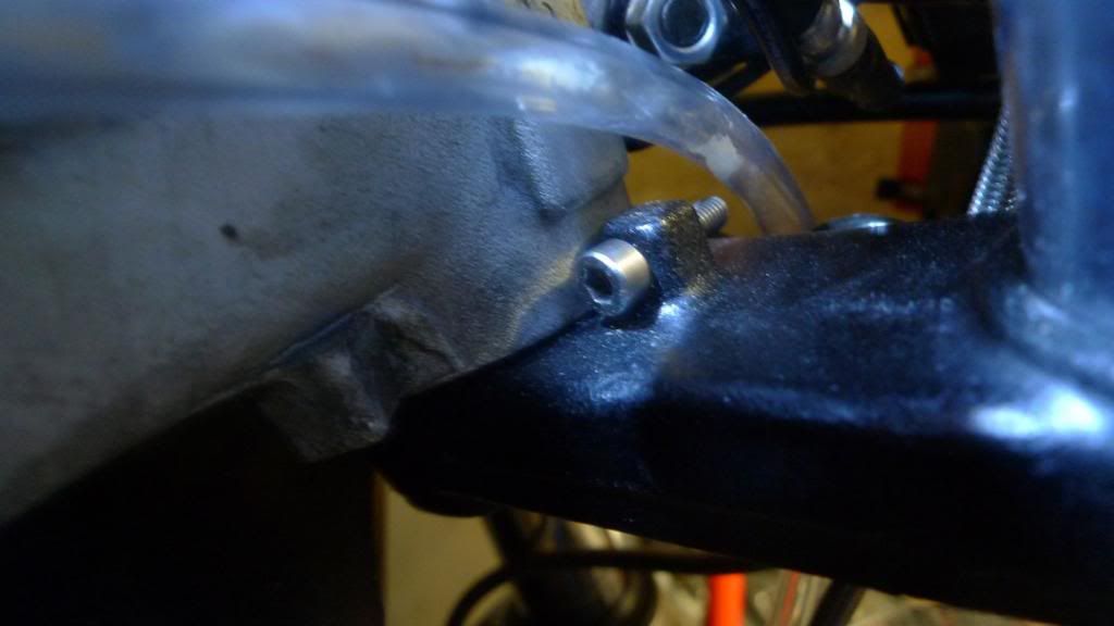

So ... :
front off and time to attack this sorry little fellow:

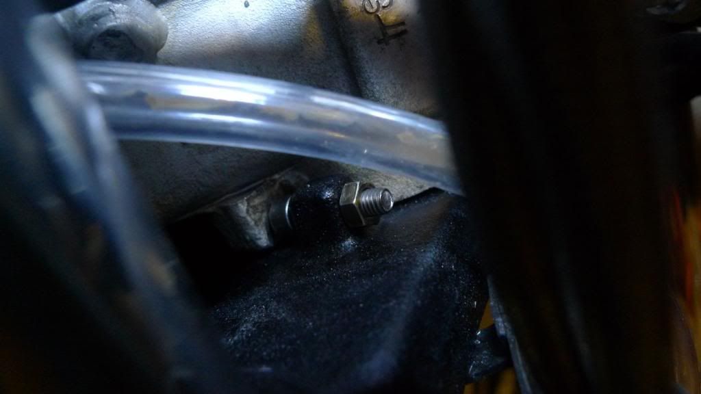

and get a bolt in there to reduce the lock:
and secure it at the back:
Now the bars don't smack anything so *hopefully* that will mean no more handlebar shaped dents in the tank and frame.

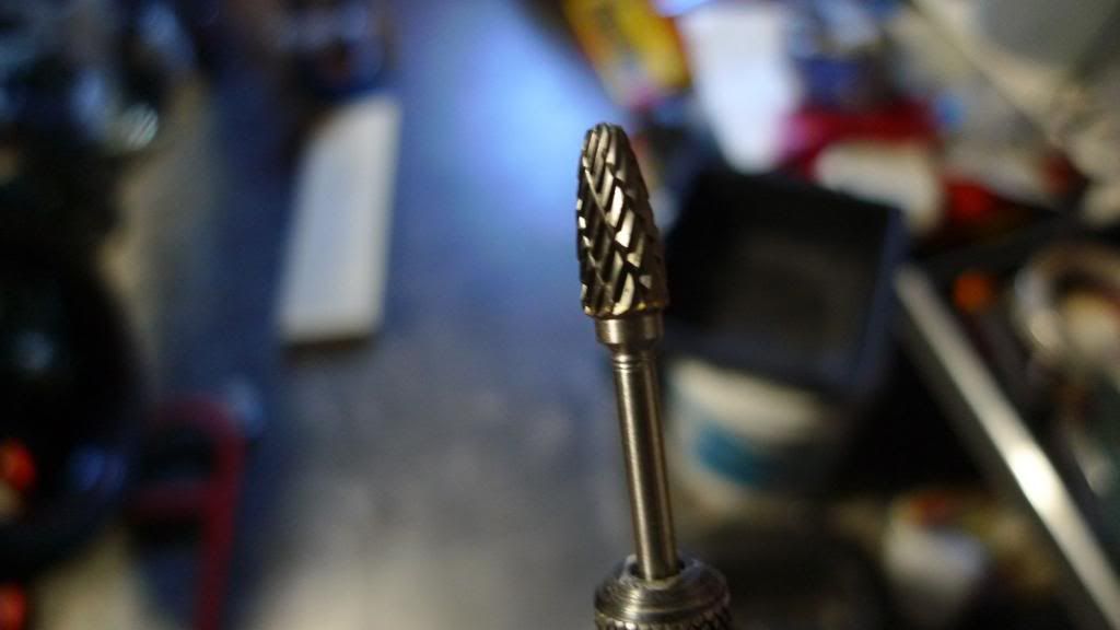

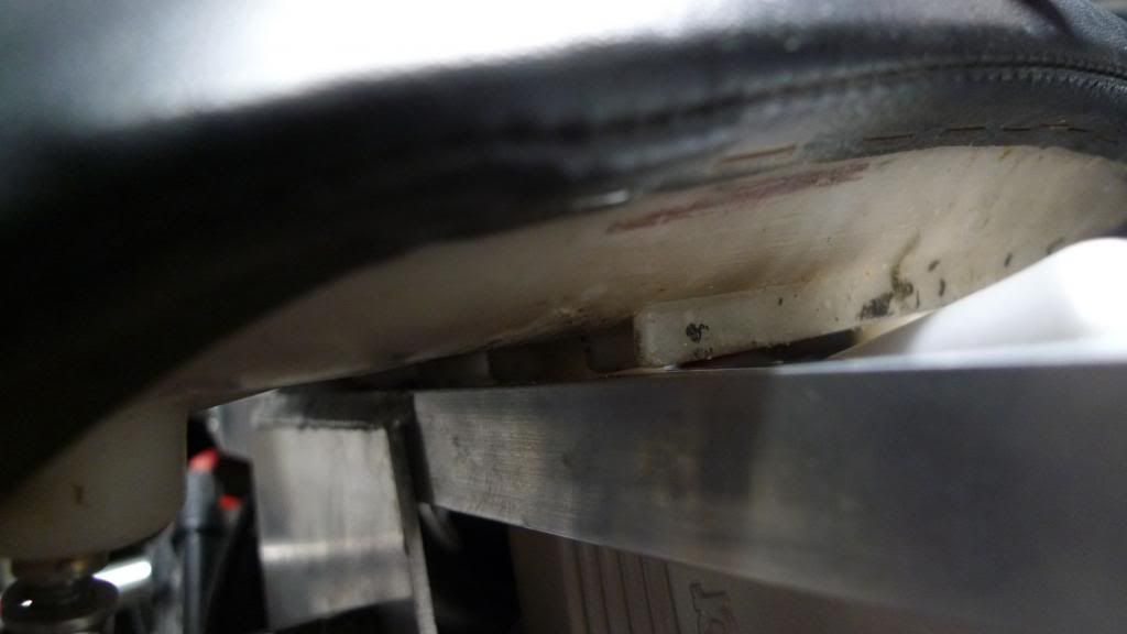

Also ... with the RO aluminium subframe the rear upper seat mounting holes seemed never to line up and getting the seat unit on was a struggle. This was the cause .. the seat has these little things under it that seem not to quite fit:
Note the wear on them:
And I reckon the (erm) titties can go too. They may have served a purpose with the real subframe on but no longer. So .. enter Dremel bits:
and we get to this:
and a quick test fitment of the seat puts the hole in the right place (crap photo though):

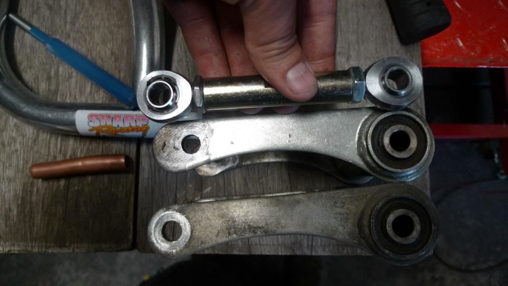

oh, and 28hodge, re the drilled out and repositioned hole pull arm thing, I thought it worth lining up a couple of pull arms along with the adjustable one to see if the repositioned hole thing could be replicated with the adjustable pull arms I have:
Below is a pic of stock pull arm next to drilled pull arm with adjustable thingy next to it. The wide angle of the camera distorts things, but you get the idea:
nope. The adjustable pull arm tube I have is just slightly too long to replicate either 8mm shorter than stock or just stock.
So .. if you wanted to replicate stock or the the 8mm redrilled pull arm with an adjustable setup, you'll need a slightly shorter connecting tube. McGill will likely be able to supply.
