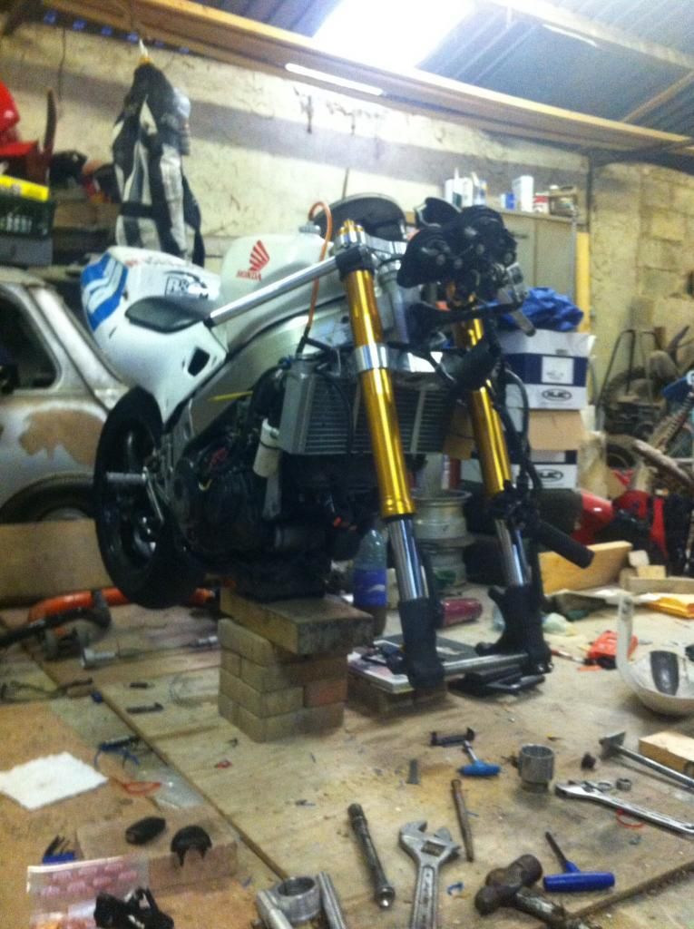

All bolted up and seems ok, calipers on but struggled to get a good measure in the spacers, used some lock wire in the end and marked that then measured it, reckon 25&20 is pretty much right.
Had an interesting discovery, my "nc30 forks" appear to be, well, not nc30 forks, they are 720mm from axle centre to top. Not 698 as nc30 forks should be.
I think they are nc23 forks, as when I originally bought the bike it had nc23/29 fork lowers and calipers on the front of it, I assumed someone with a nc23/29 had robbed the lowers and brakes to upgrade their nc23/29 and exchanged the lowers hence why my nc30 had nc23/29 fork lowers and brakes.
So I just swapped the lowers and sorted some nc30 brakes out and cracked on. Apparently though I was wrong. I'd had them set up with 5mm through the top yoke as recommended and assumed my geometry was bang on with the dog bone mod but it wasn't the the trail will have been out making it slower to turn.
Which brings me onto my next problem, I was going to put the 675 forks in and mimic the measurements that I had to keep the geometry as it was, but this isn't an option now, so I was unsure where to set the 675 forks?
Nc30 forks are 698mm then you run 5mm through the top yoke so from the top of the yoke to the axle centre is 693mm. However with the nc35 headset adapter I have raised the top yoke 20mm so do I account for this and set them at 693mm plus 20mm so 713mm from top yoke to axle centre. I basically dicked around a bit then remembered that the lad in the IOM I was chatting and emailing about this had told me how he ran them so I found his email. He had his at 9mm through the top yoke. So I copied that as a starting point.
Then checked the trail measurement with some string lines, not good 110mm trail. But then when I got home to check it turns out I measured the trail wrong as I used the centre line of the forks rather than the headset I think with maths I can work out the difference but I think I am missing some measurements so may have to re measure it properly, I probably would anyway to check my dodgy maths if nothing else.
I don't really want to drop the forks through anymore anyway, as the clip ons are starting to go off the 50mm section of fork where they taper down to 48mm I think.
So anybody who has done this mod, where are you running your forks?
