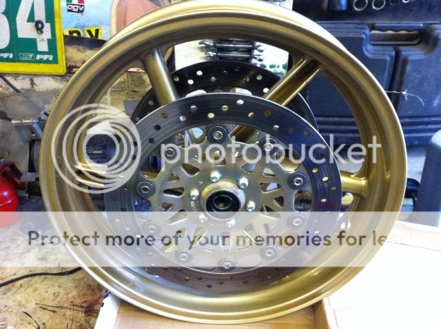

Tried cleaning the dics but they would just not come up very nice.
So I cheated and robbed the very clean ones from the Foggy rep and replaced them with the not so clean ones. That bike is nice but not uber clean.
And heres the result.
And marked up with some F1 style Torque seal.
Its boxed back up now with the matching rear waiting for tyres.

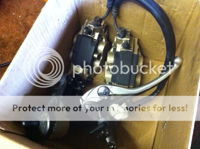

Pulled my box of brake bits out. Got a blade radial master cylinder in there. No idea if the ratio is any good, will have a closer look later.
The callipers need a good clean up but are in very good condition. I will reuse the seals unless I see something necessitating renewing them.

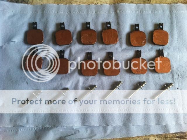

Managed to get the billet 6 pots back together and on the bike this weekend.
Here they both are after I repainted them with black caliper paint.
Nice and clean now

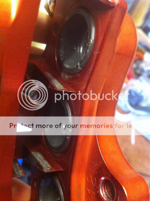

Pushed the pistons back out, applied some grease then pushed them back in again.
Copper slipped pads and zinc'd retaining pins
All on the bike with the protective wrap on the brake lines
And finally a bit of tart factor
Nice and clean now
