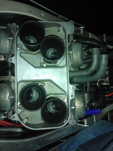

the breather spiggot is 6mm dia but its a little loose, id go for the 5mm hose brethrinalexwitham wrote:Any ideas as to the diameter of the hose?

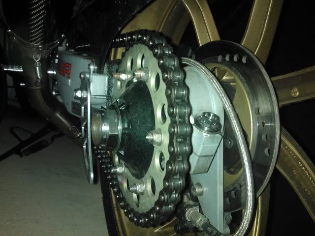

i did a bit of work after the dyno new C&S did have a 14T sprocket but swapped back to a 15 as i didnt like the high revs when travelling on the MWay,Neosophist wrote:Did you ever get it running properly?

carbs have been on and off and i did get the flat spot minimised a few weeks back, took out a washer and stuck some RickO needles in, ive removed a further washer to try that but i think im going to put one back as it feels its a little worse and C3 is idling funny, also have NC24 slides to fire in that last time i couldnt put in as the diaphram had shrunk.

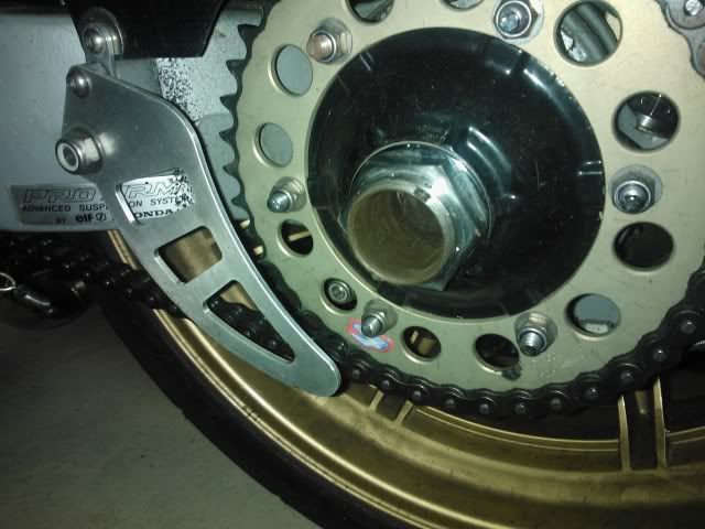

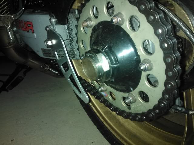

Rick, where did you get your heel guard from?
I'm looking for one for mine..........
Tygavfrderek wrote:Rick, where did you get your heel guard from?

It's easier than it looks, I changed one the other week and was a lot easier than I thought it would be.... quick wire brush and a spray with silver Hammerite...

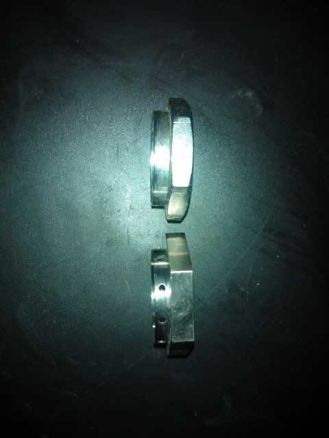

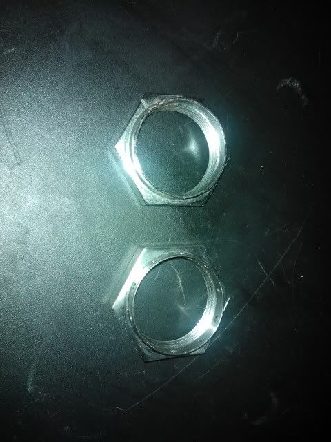

Titanium & NC24 goodness ahead,

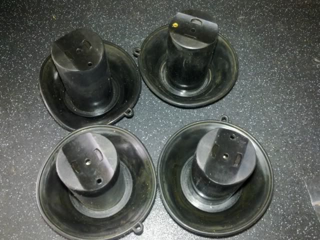

fitted my NC24 slides, drilled the hole to 2.5mm to match the NC30 ones, whacked my Rick O needles in and put 1 0.5mm shim in, having a idle problem on Cylinder 3 so i hope the 0.5mm will lift the needles enough to make it idle better,
Nc30 slides 53mm
nc 24 slides 55mm & to the bottom of the curve 53mm
will see what difference these make to my flat spot, and hopefully suring cylinder 3 idle issue we shall see!
the rear slides in the pic are the NC24 and the fronts are NC30 in that pic,

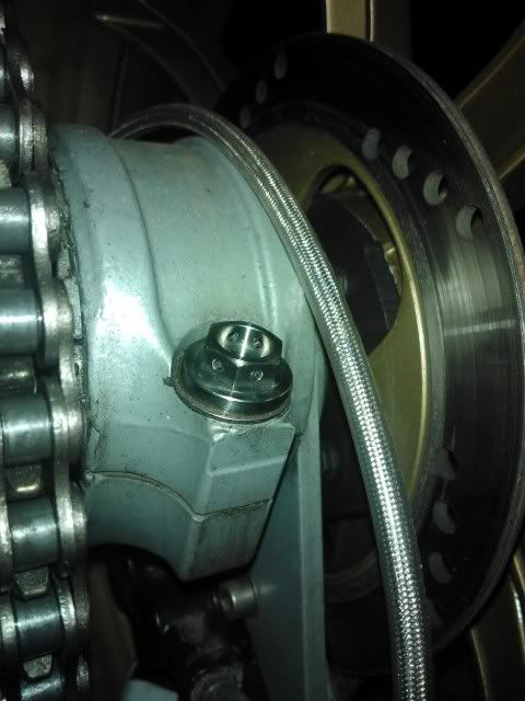

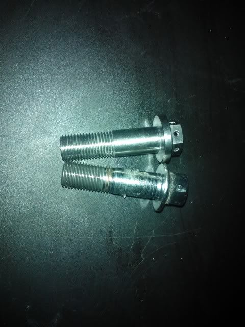

Titanium Goodness courtesy of our very own Kayla / Projection Componants, look the fricking nuts
dont they
Nc30 slides 53mm
