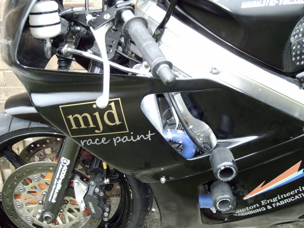

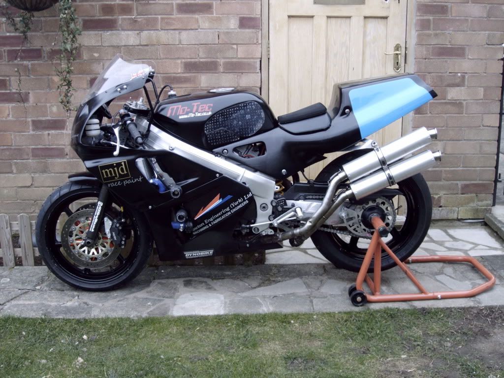

Managed to drag it out into the daylight today due to me wanting to get cracking with some upgrades to my 3ma so needed my bench free.
Its covered in dust in the pics due to me having to make some adjustments to the lower fairing now im running the electric water pump and not have time to clean it.
Managed to flood my original NGK's so stuck a set of ND's (my prefered choice) in and its back to normal now but still need to adjust the exhaust as its not sitting how i want so will have to give it a gentle tweek when i get chance

Went to Dynobike yesterday to see what she is pushing power wise, after a few minutes of going through the box to warm her up she pushed out 67bhp. Im well chuffed with that and cant wait to get out on her.
Its running a smidge lean at high revs so off up a size on the mains to make it right.
