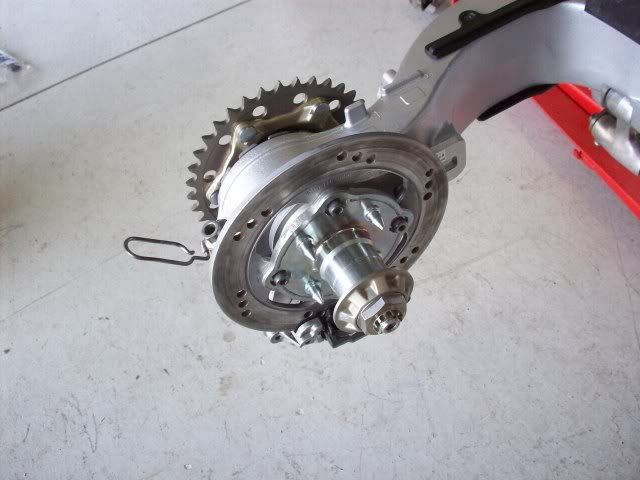

Added two old shims (HRC spec 5mm) I had from a previous bike to add some rear ride height. The round shape didn't fit in the recessed area in the frame, so I had to square them off.

And the rest. Big F'n socket set I borrowed from a friend for the rear axle nut.
