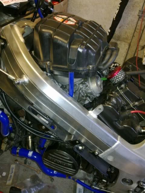

Samco Cooling Hoses Fitted with new SS hose clips, System refilled with Silkolene Pro Cool.
5mm hose fited to the petrol tank breather, and 8mm hose fitted to the air box condensation trap pipe.

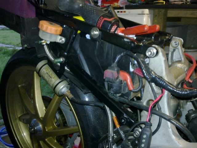

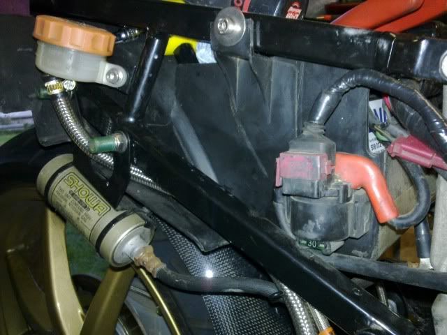

Coolant Catch tank fitted next to RHS head light until it is removed, where i shall relocate.
and old expansion/over flow bottle gone!

It seems a little bit of blue overload to me! Where did it happen that Samco hoses (and blue ones specifically) became de rigeur whenever new hoses were needed?
you say blue over load its all under the skin when the plastics are on, i had a red silicon breather on the petrol tank and thought it would look shit if i had blue hoses elsewhere, and i thought fuck it ill do the others, got the hosing from ebay one company AFS where complete morons btw, so be aware before you buy. hoses only cost me about £12 so didnt seem a huge expence to match them all up.
