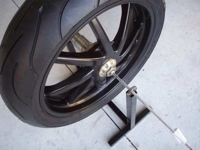

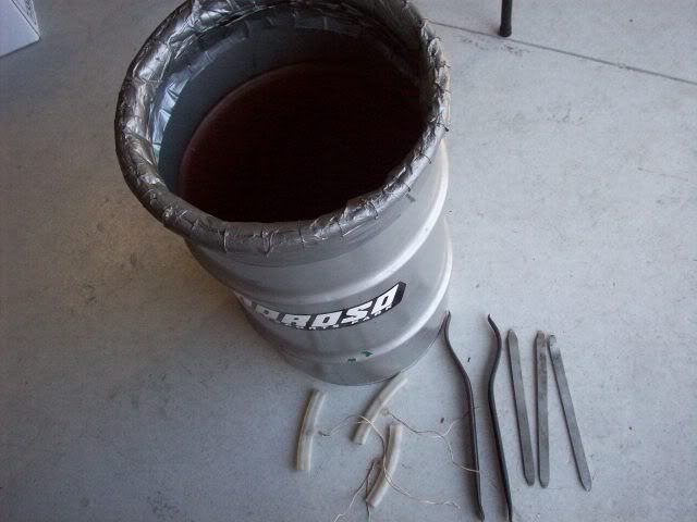

Here is my tire changing set up. Bead breaker, static balancer, rim protectors, tire levers, and old steel drum work station. Can't balance the rear on standard set up because of the offset of the rim, a little tilted, doh! Mounted up the rear hub assembly and used a smaller steel rod. Worked OK.

looking good :)
hope you fitted the discs before balancing the wheels up.

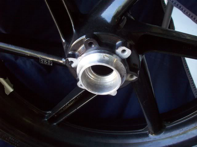

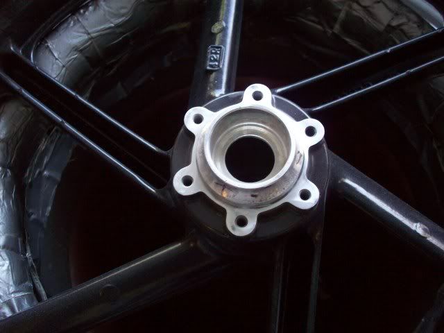

Of course, if you remember, I had to clean up the excess powdercoating. THe guy wouldn't be in business if he didn't know where NOT to powdercoat. Very CAREFULLY used a small 3M wheel on a small grinder. Did I say CAREFULLY?

zimm wrote:looking good :)
Yes, I checked the wheel only, the wheel and tire, and wheel and rotors to get an idea of where to put the weight. It's not as accurate as dynamic balancing but it works and it saves a ton of cash especially when going to the track.
