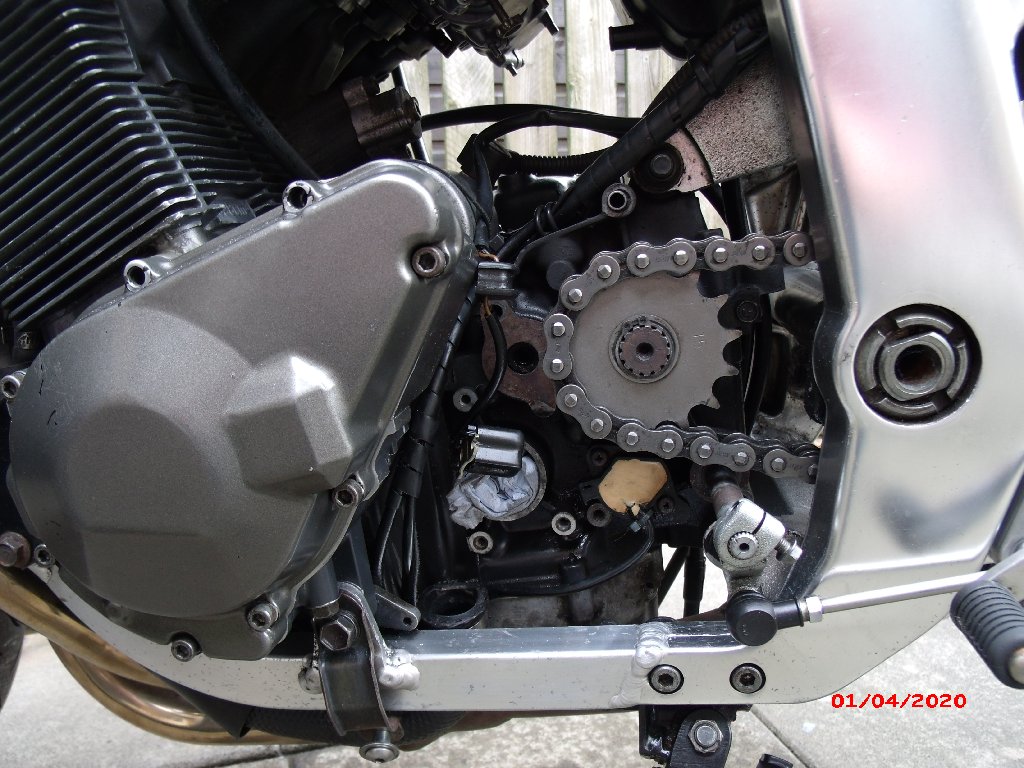

Removed the back wheel & hugger on Sunday so I could give the back end a thorough clean, including the inside of the hugger !
As the front sprocket cover's off I also gave that area a good clean. As you can see, the coolant pump's been removed for overhaul.
While the rear wheel was out I gave the rear caliper a clean & service. Thankfully, no issues found so it was re-assembled & I put fresh fluid
