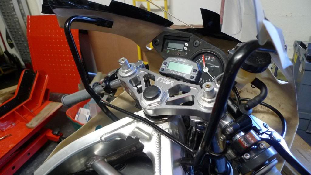

But on the NC30 front ... I decided to ditch my copper pipe efforts for now and do as Cammo says and violate a stock NC30 brace.

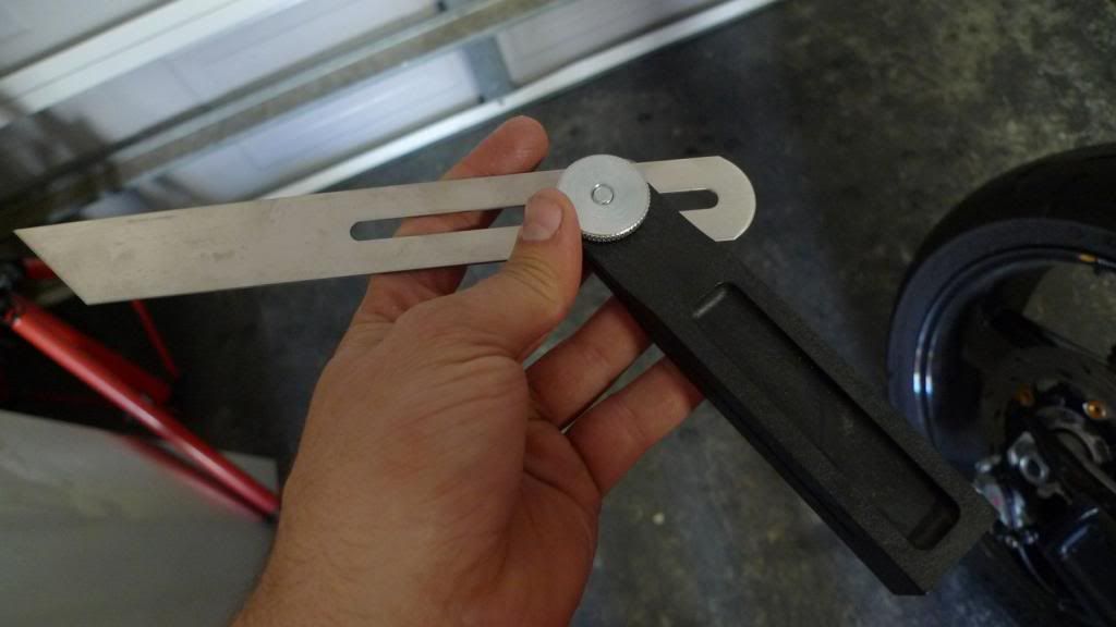

So I bought a cheap one of these to help me get the angles the same on each side:
And with some time in the vice, then on bike, then in vice, then on bike, then in vice then on bike etc etc :
Photo is a bit wonky, but in reality it is pretty straight:

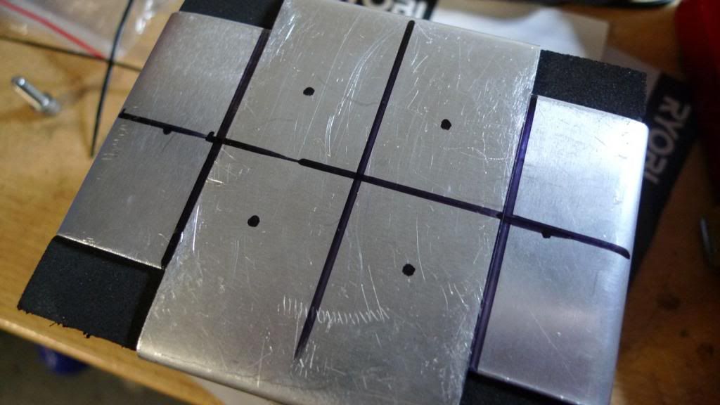

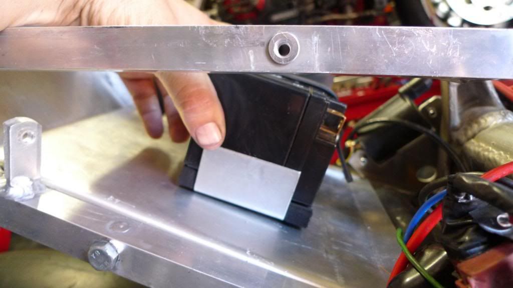

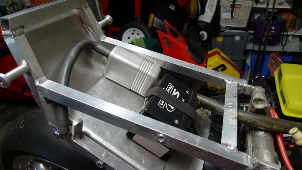

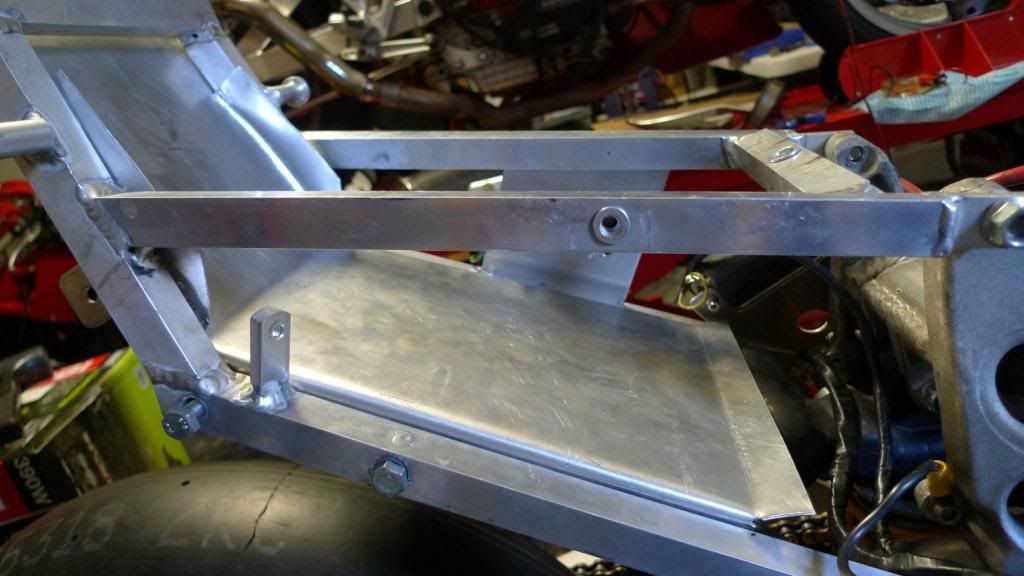

You may recall how crapped off I was with the battery box situation, that my fantastic mudguard-batterybox might be hit by the rear wheel. This guy:

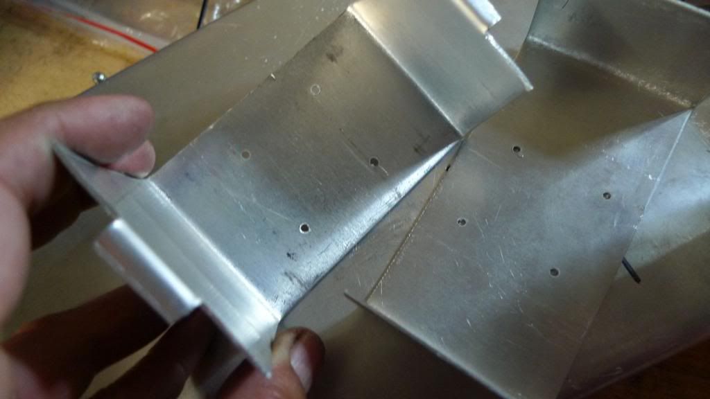

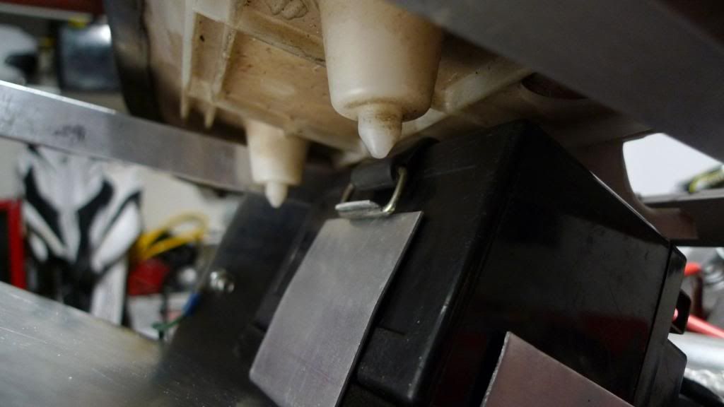

So, being a tight fisted lazy git I thought "why not just turn it over and bend stuff until it fits?". Before I had the tray sitting below the line of the lower subframe, I'll turn it over and see what happens:
Bingo.
A few quick measurements show that it'll take about 135mm of rear wheel travel to hit this guy. Granted that stock road trim is 120mm. That should be enough. Remember folks, I am a moron, and this is experimental science.

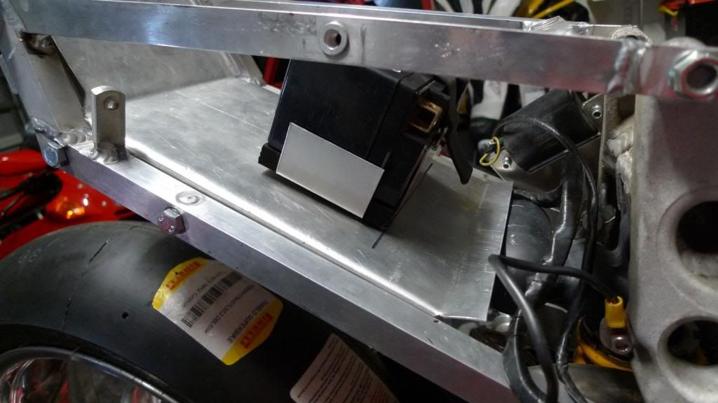

So a quick battery fitment check:
And things look good.
Some quick late night measurements and some drilling to get the rivets in

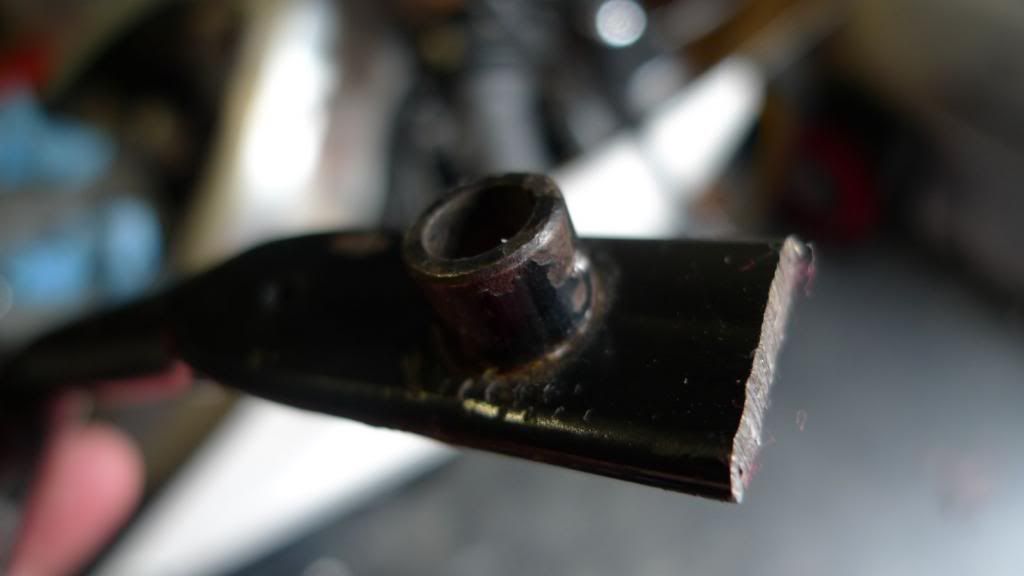

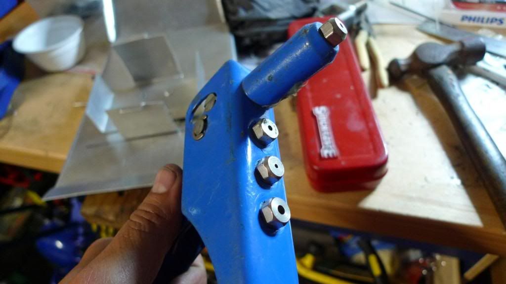

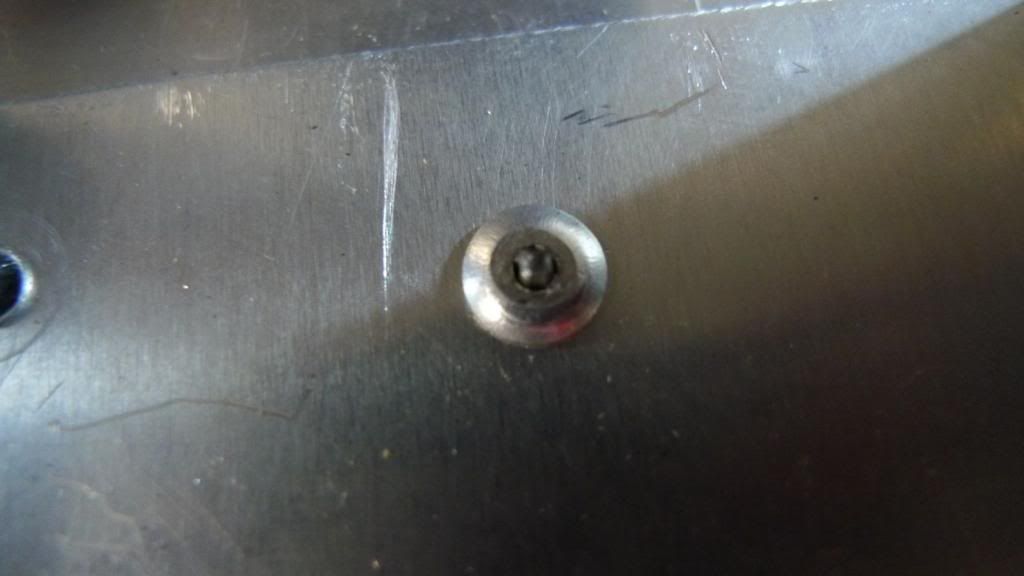

Now ... let me tell you about my riveting skills, and my riveter. First of all, I have never riveted anything in my life, so this is all virgin territory, and secondly, I got my rivet thingy from a 'deceased estate' so it just might be pretty ordinary. It looks a little pre-war:
And it really was shite. Rivet ends got stuck, and this is how stuff looked:
not great. So, bin the riveter, and despite only having two rivets in (pending purchase of new riveter) continue with the science:

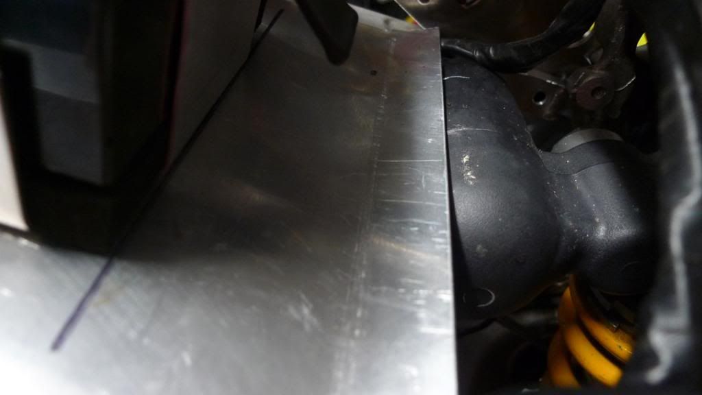

The end of the tray is just sitting on the shock .. so this'll have to be dealt with:

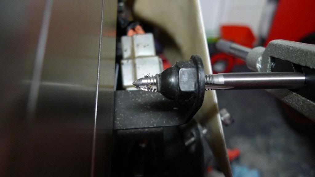

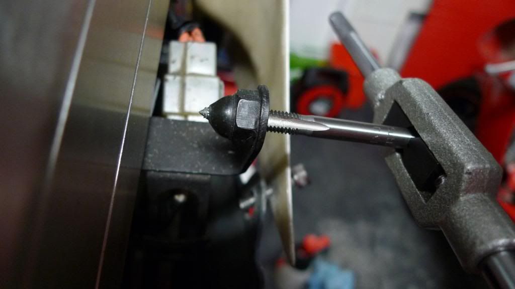

.. so some help from my cheapie thread tap set:
get the result:

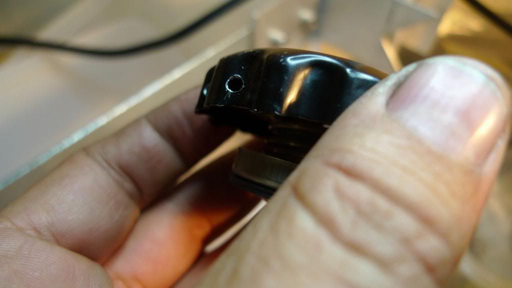

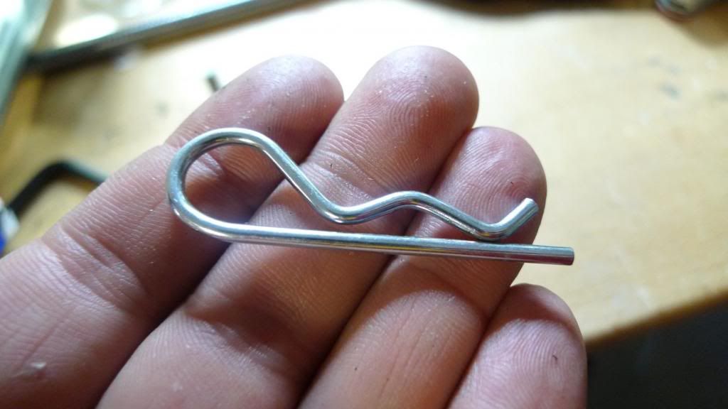

The new rad cap needs drilling for lockwire:

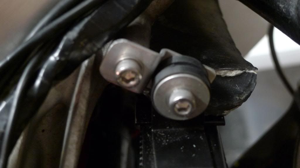

and those mounts I made to the new rads need some rounding off to make sure they don't eat anything:

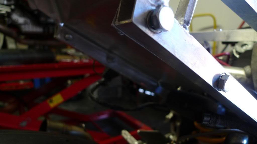

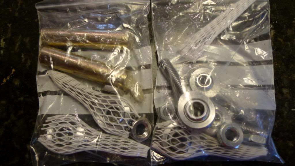

You may also recall that I had some shock/swingarm clearance issues. So, I figured I'd make an length-adjustable pull arm (dog bone) to help with ride height and clearance. I ordered the bits and here we go:
The stuff to make an adjustable pull arm between 120mm and 160mm in length .. paaahhlenty.
A quick inspection assembling of the parts reveals a very very high quality setup:
Offering them up to the installed HRC setup show they will be okay on length. I have many things to do before revisiting the shock though. Stay tuned.

Love your idea of the adjustable dog bones. I've seen that set-up before but wondering how it would affect the rising rate, etc, from when it's set to 120mm long compared to 160mm?

StrayAlien wrote: Now ... let me tell you about my riveting skills, and my riveter. First of all, I have never riveted anything in my life, so this is all virgin territory, and secondly, I got my rivet thingy from a 'deceased estate' so it just might be pretty ordinary. It looks a little pre-war:

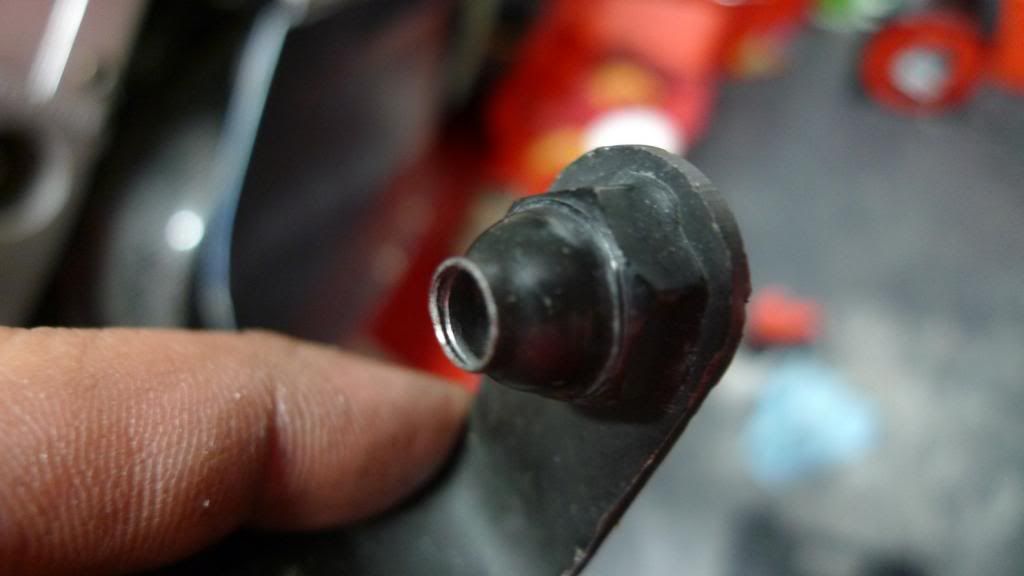

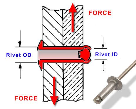

Mate, don't bin the pop rivet pliers just yet. Digging deep into my memory, and going back to my metalwork 101, the problem you have could well be your choice of pop rivets and not the pliers.
As I recall there are two different types of pop (or blind) rivets one is a "break head" and the other is a "break stem" type of rivet.
As the name suggests the mandril (the bit you pull with the pliers to form the rivet) on a break head rivet is designed with a weak spot just below the head of the mandril. as such once the rivet is properly formed and the tensile load through the mandril reaches a certain tensile load it will shear just below the head...like so:
Whilst this leaves a nice visual finish it is actually the weaker (but not weak) option of the two as the rivet in effectivly hollow.
Alternativly, and what I suspect you have used, is the "break stem" version of the pop rivet. Once again as the name suggests these have the designed weak spot on the stem of the mandril so it shears further down. This leaves part of the mandril inside the newly formed rivet, making it stronger (as it is not hollow) but cosmeticaly is not as appealing sometimes...like so:
You could use either for the battery box job you are doing, but there is nothing wrong with just buzzing over the head of the formed rivets with a file or sanding disc to tidy them up :peace:
