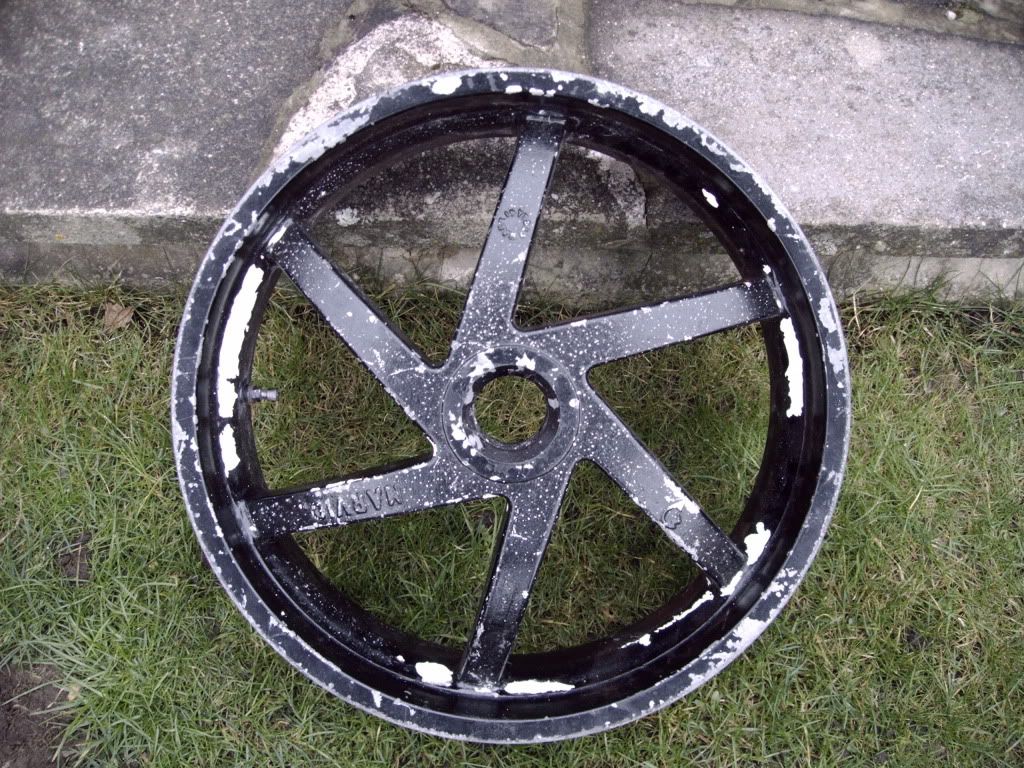

Went to see a friend today to buy some wheels for my 3ma and in the corner was this
Its a lightweight wheel off a Honda rs250, i know it will be running backwards and looks rough but hopefully once crack tested i can use it as a wet rear. If not im gonna stick a clock in the center of it and hang it on the wall
Re: Project track dog! Getting less doggy!
Marvic! Nice mate how wide is it?
Not had a tape over it yet but it looks about a 5". Perfect for a 165 wet.
I cant believe how light it is mate. It makes the Dymag feel heavy!
