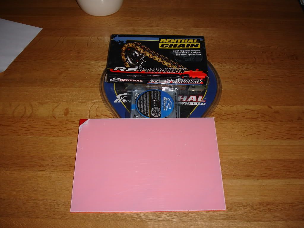

15/40 gearing for the road and theres a 14T on the way for trackdays
The amber perspex is to replace the lime green i previously brought for the lense covers to look something like this hopefully

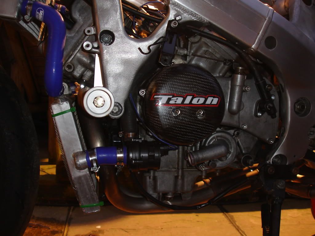

Water pump fitted
Fits as if its meant to live there
doesnt really need one but i shall make some sort of bracket for it, the blanking plug for the stock pump didnt work so back to the drawing board for that one. Finished the electrics off today too so might a chance to fire her up and listen to these

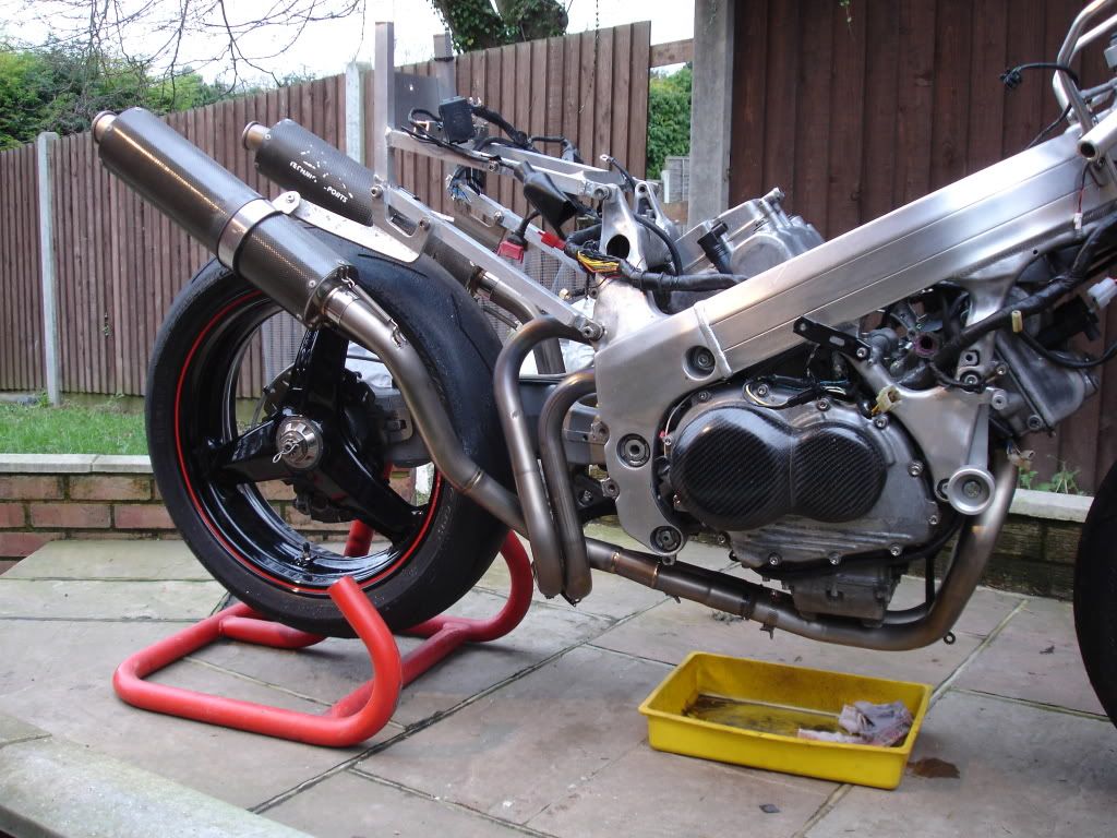

Well happy with the condition of the pipework, cans will clean up and look ok swapped over to hide the damage. Im still amazed at how light these puppies are.

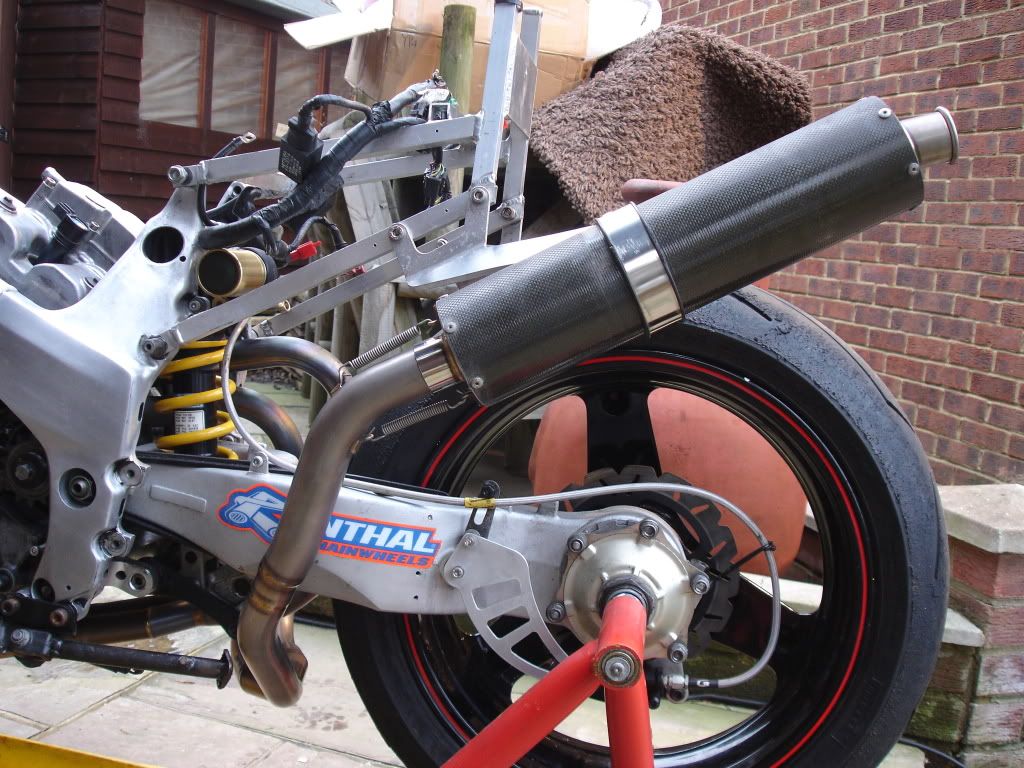

Just so you know, the pipework weighs just 1.6kg, not too sure about the cans though, but with carbon and Ti end caps, it won't be a huge amount
