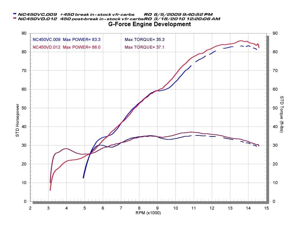

My recent experience with Cryo suggests that it is worth every penny. Not just for preventing failures from breakage, but prolonging the life of the parts. We are finding that many of the parts are now discontinued from Honda. So, making them last as long as possible while abusing the snot out of them is critical to the longevity of these bikes. My vote is Cryo EVERYTHING!!!! REM polish anything you can as well. It's worth power AND longevity.
It's doubtful the pistons will weigh exactly the same as stock. Since this is a 360 degree flat-plane crankshaft the balance is absolutely critical to keeping the thing from shaking itself to oblivion. Get the crank balanced, Cryo'd and REM polished and you will have a very happy crankshaft. These guys kick ass on pricing and quality of service: http://www.cryosciencetechnologies.com/ Here's the gains from just Cryo and REM to one of our 450s. This engine is EXACTLY the same parts and set-up. It has just had the parts sent to Cryoscience.
Excuse the Blue graph cutting in-and-out, our tach pick-up on the dyno is old and failing sometimes.

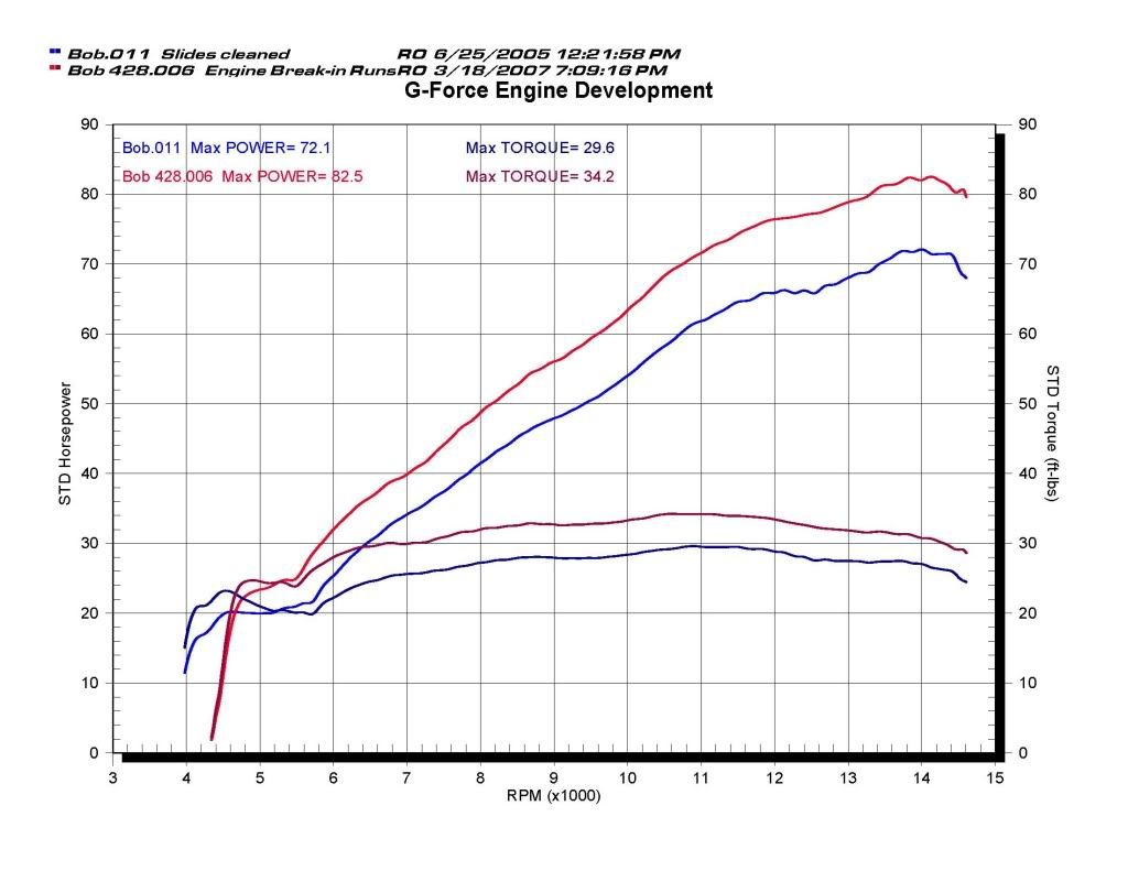

A tremendous amount of power gains are in the heads. Since these bikes are so highly tweaked for power from Honda, the ports are extremely sensitive to changes. Especially changes in the wrong direction. So, make sure whomever is doing the porting knows what they are doing. It's really easy to kill 2 to 4 horses just in the exhaust ports. We are making over 80hp with the following mods ONLY:
57mm pistons
Porting
NC-30 carbs with stock airbox
RVF HRC Ignitor
The following parts are bone-stock:
Rods
Crank
Valves
Cams (not even timed)
Here's a graph showing the difference with stock pistons vs. 57mm CP Pistons. Everything else is the same (this used to be my bike).
So, there is a ton of power to be extracted from these engines if you do it right. So.....do it right.
