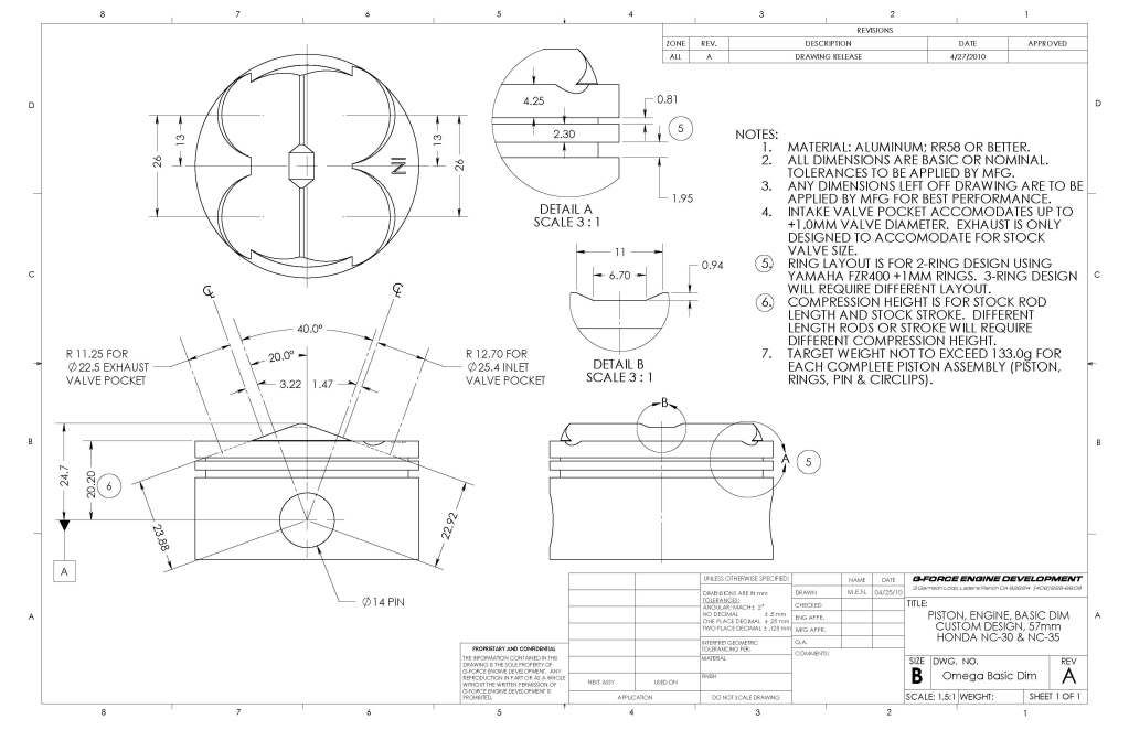

I almost have the drawing done. I've been short on spare time, but will try and finish it this week. Sorry for the delays.CMSMJ1 wrote:Sorry for my taking my eyes off the ball here - I've got too much on to make this happen.
So - recap...Mike Norman or Mike Lohemeyer were going to drop a cad file/details of the pistons at 57mm for the +2 piston so we could get Omega to get cracking and confirm what would be weights etc?
Mike Norman
G-Force Engine Development
g-force performance
- Posts: 288
- Joined: Thu May 29, 2008 5:58 am
- Bike owned: VTR-250, VFR400RR,
- Location: Santa Clara County, California, USA
Re: Group Buy - Honda 400cc +1mm pistons -
OK guys. Here are the basic dimensions to follow with the pistons. This drawing is specifically for:
57.00mm bore
Standard Compression (pin) Height
2-ring design.
I believe this is what everybody has agreed upon. If I am incorrect about that, please let me know and I will correct it.
I am also sending the drawing to Jim (JGRC30).
Cheers.
Mike Norman
57.00mm bore
2-ring design.
Cheers.
Mike Norman

Thanks for taking the time to post drawing mike i'm keen to have a set ASAP.
