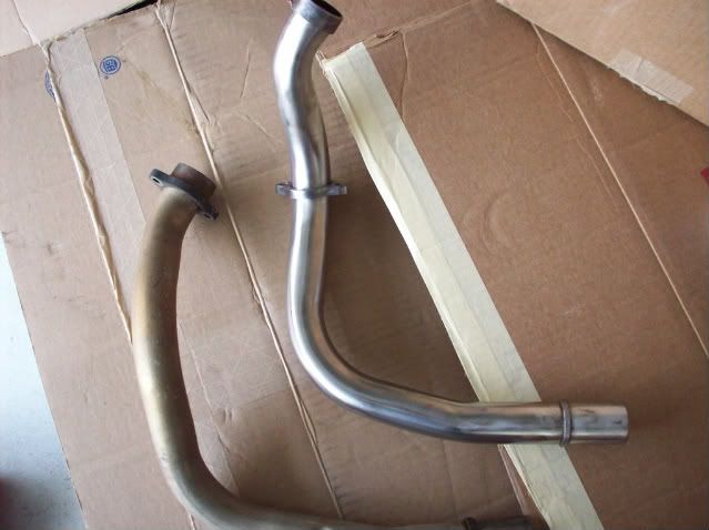

Did some work on the exhaust yesterday. The inside diameter of the race can is smaller than the stock one where it attaches to the exhaust flange. There are two layers of exhaust flanges on the stock header pipe and I had to remove the outer one which is welded to the flat part. A little hacksaw and some grinder work and it's gone. The 3 bolt mounting pattern is slightly different as well on the "Top Secret HRC" race can and if you look at the first pic you can see black Sharpie pen where I have to grind out the holes to make them slightly oblongated. Since the inside diameter is smaller the stock exhaust ring didn't fit either so I had to take out about a 1/2 inch section to close the ring down. It looked like a solid structure until I cut into it and realized it's actually several rings of different materials. I'll line up the split in the ring next to one of the exhaust flange bolts just in case there is any slight blow by. Also been cleaning up the exhaust pipes with the wire wheel and bench grinder. Took about an hour to do this one piece. Cheers!
