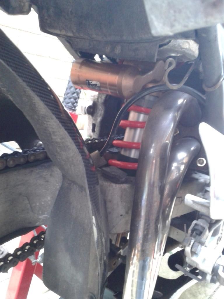

While I had the bike out the garage on stands I thought I'd fit the HRC link and new BMW shock I had bought a few months ago
So out came the heavier sprung shock and standard linkage.
New shock next to the heavier sprung one. The red spring looks more factory, but I think I'll miss seeing that nice purple under there.
And in goes the new linkage and shock, after filing the new shocks top mount
