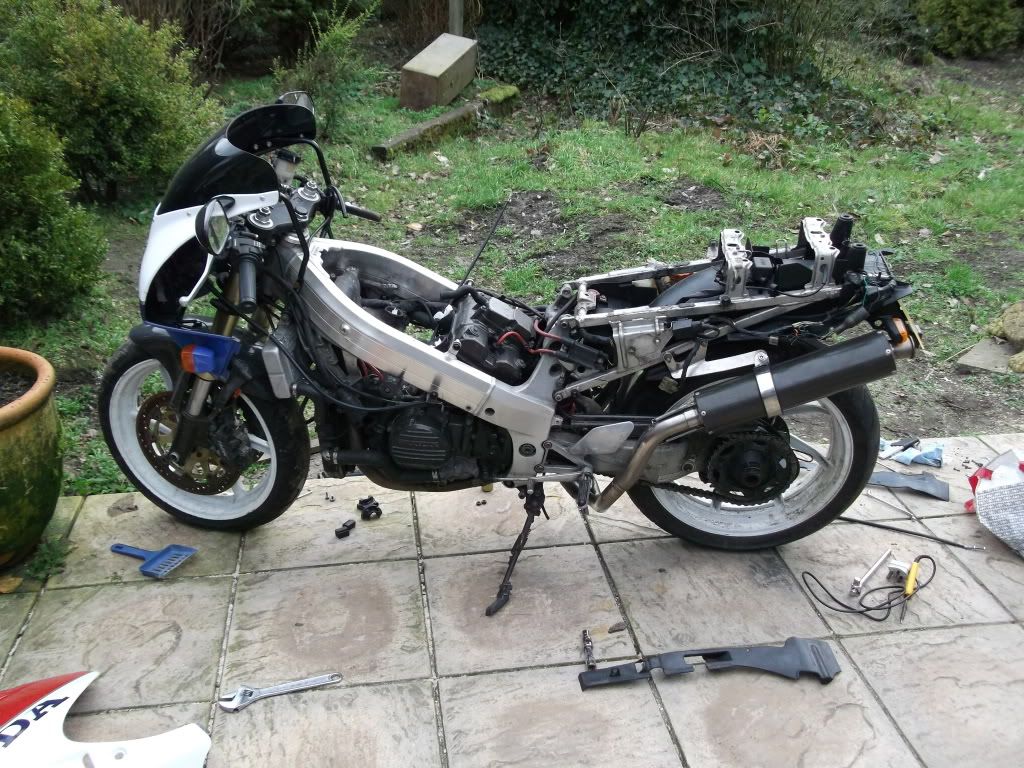

Right, got power back again after realising I'd hooked the starter solenoid up backwards, I just have to tape the wires up and it'll be done :) Tomorrow will be filled with getting the carbs back on the bike, after cleaning the top of the engine anyway :)

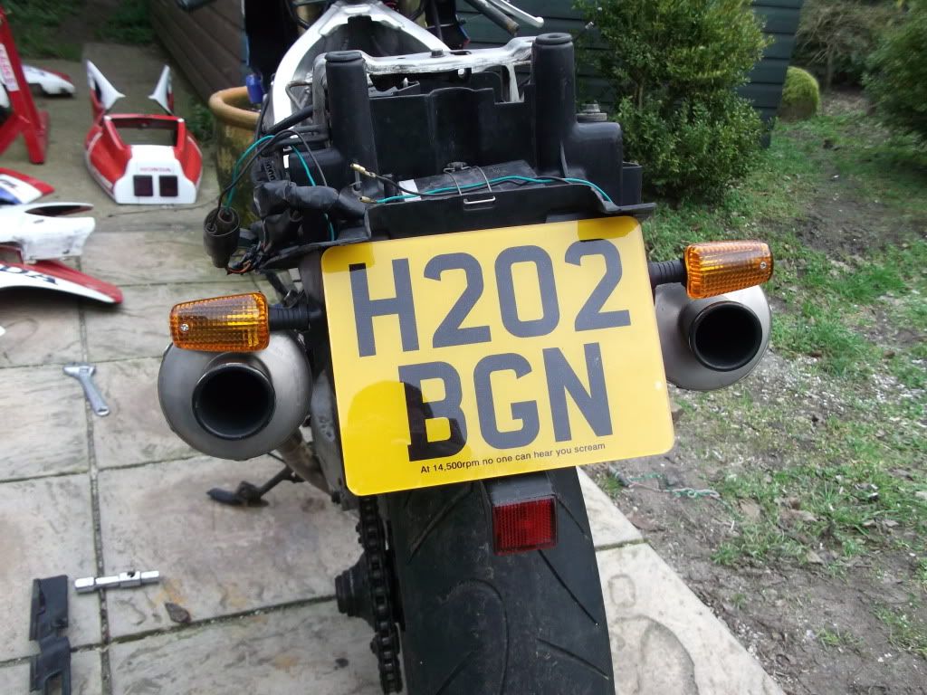

My only achievement today was finally properly taping the loom up, I have to give it a quick once over in the proper light still, but it looks like it'll be just fine taped all of the bare connections first, then bound all of the wires together, so looks fairly stock from the outside.
I've tested all of the electrics, and the good news is they all work fine, the engine spins over (but won't start due to having neither a reg/rec or carbs atm) so can only assume it's all good no more annoying alarm going wrong and not disarming at me
By the end of sunday I will have the throttle grip reassembled, and at least made a bloody good effort to get the carbs back on properly, I might even have it running aswell if I'm lucky

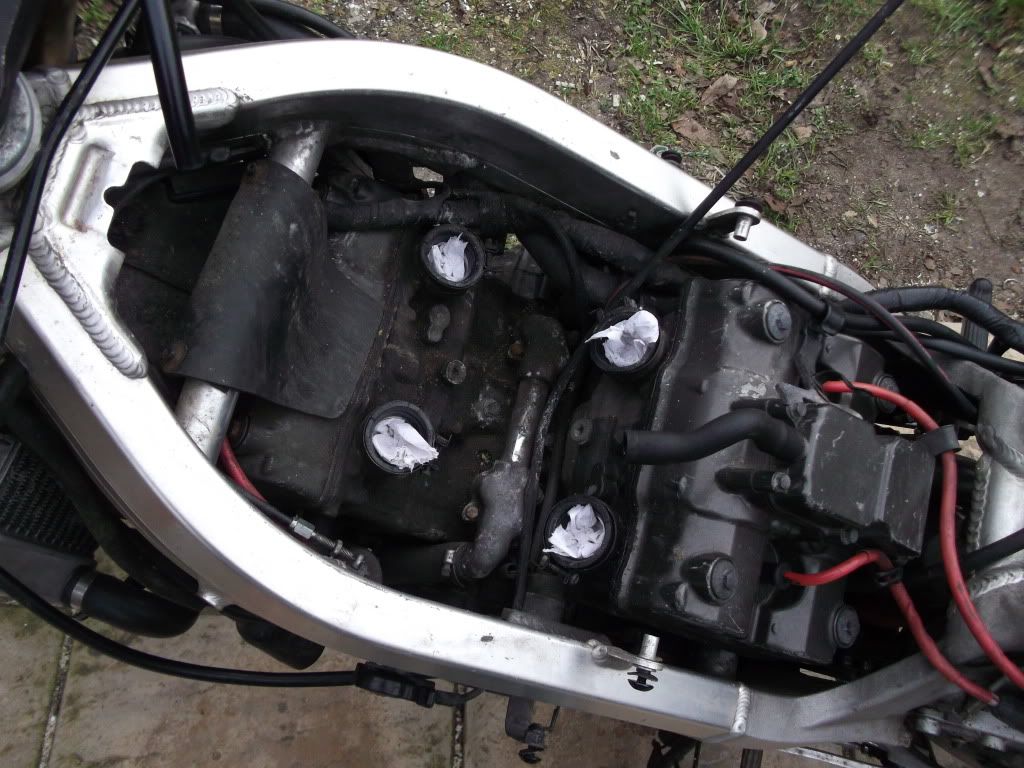

got the carbs back on the VFR with next to no trouble, who said they were the devils own design?
All in all, I think it took me about 15-20 minutes to get them from being in the shed, to on the bike ready to have the clips tightened, only really needed a smear of WD40 (sprayed it onto my fingers then wiped them on the inside of the rubbers) and they went in with a pop. I started at the front left, got that just inside, then the front right and got them seated. This left both rears pushing down hard on the rubbers, so a little bit of pushing got the rear left in place, and the right followed suit after getting less than half a cm of rubber to stop bending inwards with the help of a tiny flat blade screwdriver
Now hooking all the cables and stuff back up and it should be ready to start within the next hour, just those last PITA jobs to do (cable lengths, hoses, airbox etc)
