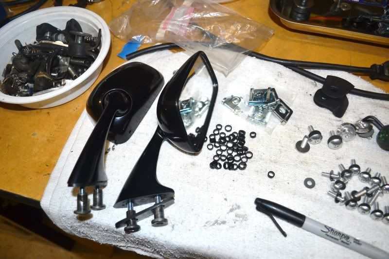

Little bit of an update, sorry nothing super exciting. I've been trying to straighten up all the wiring, hoses etc and replacing small things here and there now that it runs.
My mirrors were Emgo's so I ordered some brand new OEM's.

Dude, where did you get the OEM mirrors, and how much were they?
rgvsp
- Posts: 228
- Location: Atlanta, GA USA
Suzuki Japan. I think they were about $32 a piece if I remember correctly. I have a friend there that can order whatever you like. He does charge a fee though for the service.

thought when i got mine @ S$50 a piece was expensive but seems like its not. heehee. by the way, got mine @ singapore suzuki distributor. down here, there's few distributors selling @ different prices.rgvsp wrote:Suzuki Japan. I think they were about $32 a piece if I remember correctly. I have a friend there that can order whatever you like. He does charge a fee though for the service.

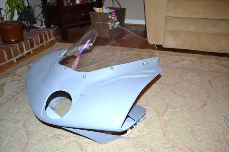

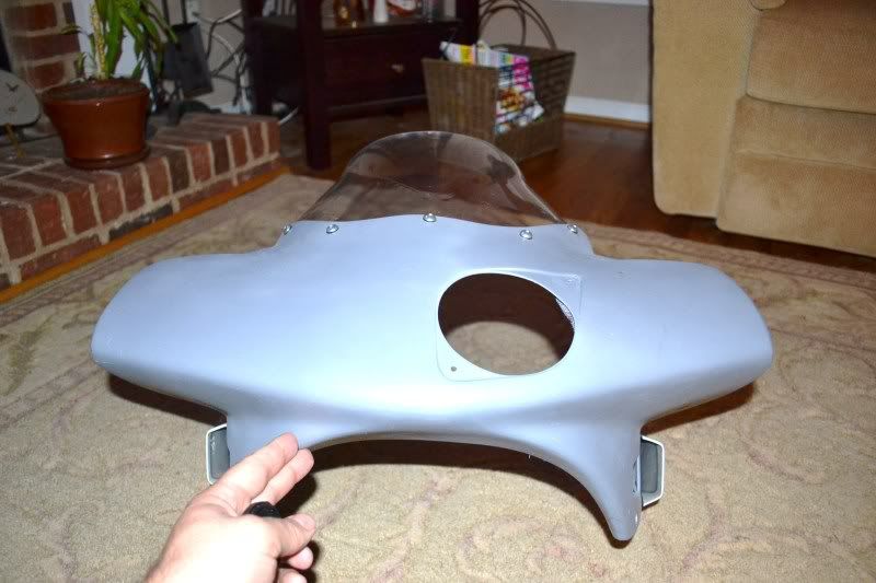

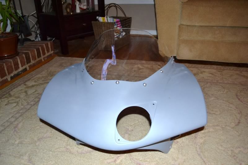

Progress has been slow lately. The heat (a lovely 106F) and fixing leaking toilets has kept me out of the garage. I did end up ordering a clear double bubble screen from Skidmarx to finish off that 90's Suzuka look. The quality appears to be very good and it fit the aftermarket upper with little fuss.
It looks pretty goofy from this angle.

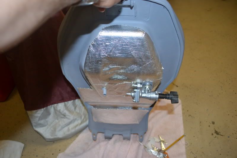

Ok, a new headache I need help with. I needed to replace the old fuel tap as it leaked. I went ahead a bought a genuine Suzuki replacement. Now, I have the opposite problem; no fuel. Here are the symptoms and I'm running clear fuel lines so I can easily see when fuel is flowing or not.
1. Bike runs and sucks fuel from auxiliary tank.
2. No fuel flows from any of the three positions when everything is connected.
3. If I connect a separate vacuum hose to back of tap and suck (insert joke here) I get nothing.
3. With tank off fuel will flow in the prime position so I'm guessing that means the tap is fine (it is brand new)
4. I did a preliminary check of the venting spots and did not find anything obvious.
What am I missing here? I did have the tank apart and hung to prime it. Any ideas?
