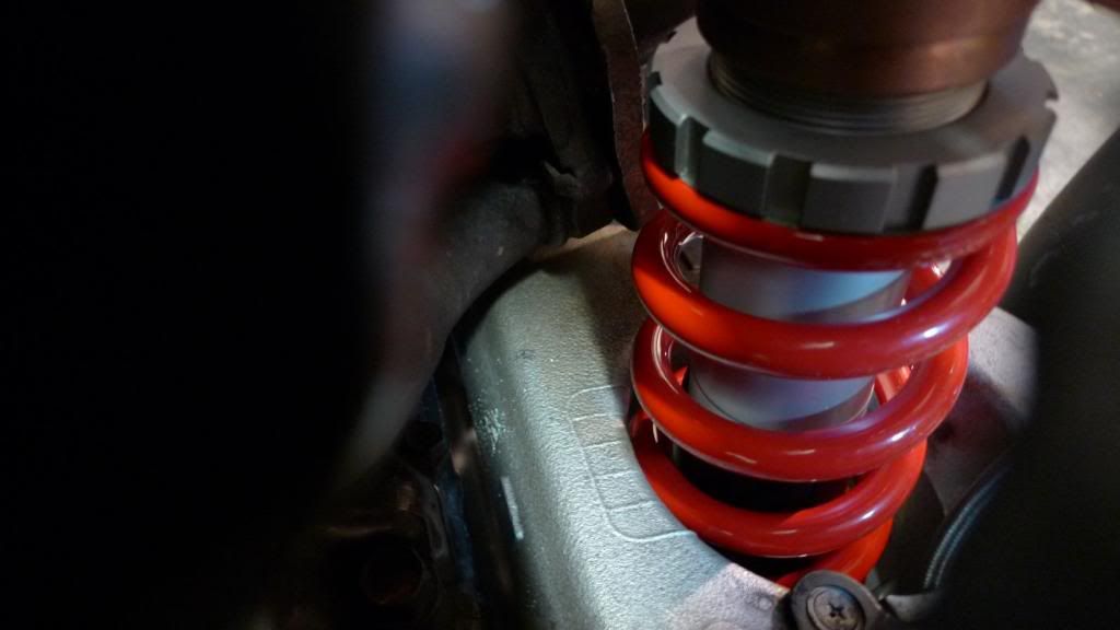

I put the BMW unit in last night and guess what, on full extension there is still fouling on the swing arm .. and this is with the HRC linkage.
With the 2012 onwards unit being 4mm shorter it is possible that unit would not foul.
With my fat butt on it, it will not foul, but that is the same case as with the GSXR. I'll be doing a sag setup today with the BMW just to see how it goes.
So .. they are both he same length and both have fouling issues on full extension (albiet the BMW less so I think). So, the bottom line is, I'll take them both to the track and give them a run, and in the mean time, I'll figure out how to make and adjustable pull arm ....

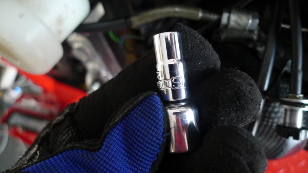

So, armed with the mechanics gloves and a socket, it was "get your hands into the furnace":
It worked well actually, with the fan on the engine temp rose very slowly. When it got up to around 80 celcius then it was take a break time.

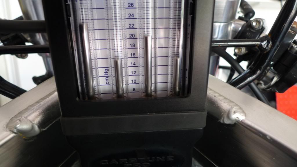

Carbs 2/4 were easy to sync, however, 1 to 3 and 3 to 2/4 just would not happen. It was all over the place and no amount of screwing and fiddling about under hot carbs would seem to get it anywhere near. At this point, I will let in on Norm's incredible carb-sync hint (he used to work on army tanks a long time ago and now races an NC30, start the jokes now ...).

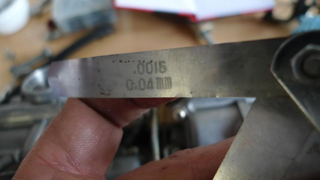

I've not heard of this before at all, but it is the "feeler guage" method of getting a carb-sync starting point without even having the carbs in the engine. Remember that these 'new' carbs are in from Japan and you may recall from previous posts that they didn't even have all NC30 float valves in them, so who f**king *knows* what has been done to them. Time to go back to basics.

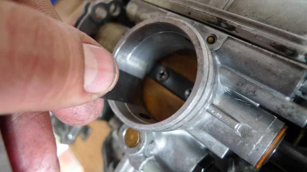

Here is the method, it is simple: get the carbs out and on the bench. Then, using the thinnest feeler gauge you have, test the 'feel' of pulling the gauge past each of the closed butterflys:
Feel the drag of the gauge past the butterflys between 2 and 4 (everything is based of carb 2 on a VFR - it is the 'master') and then make 1 and 3 feel the same. Simple. Do it on the same place on each carb. Even though the pic here shows me doing it at the side of the butterfly, I ended up doing directly in the front-middle of each.
You'd be surprised how accurate you can get just by the feel of the drag. Using that method alone, then getting the carbs back in the engine, this is what it looked like. Amazing:

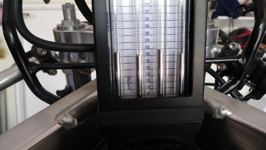

1/3 not too far off each other, and those two together not too far of 2/4. A few minutes later:
Some more tweaking and blipping the throttle and they were perfect. Nice one Norm. Beer.
