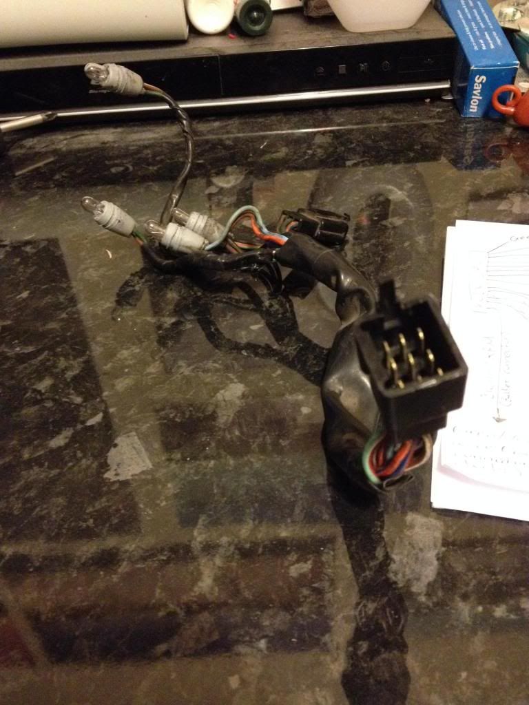

Started figuring out the dash on Thursday night and drew out my own "wiring diagram" to help myself.
Seemed easy enough once I'd got my head round it. So I got hold of the sub-loom from the original clocks (I've got a spare on the way to replace it if I need to go back to original) and started wiring that in as it was easier than butchering the main loom. I kept forgetting to put the shrink wrap on before soldering, so ended up just taping a couple of joints
The un-used wires from both ends were taped up to neaten things. At this point I left everything else loose to allow for any routing issues, as I didn't fancy wrapping and un-wrapping something because I'd got it wrong.
Yesterday morning I managed to finish the soldering on the clock loom before work and started to figure out where everything would go.

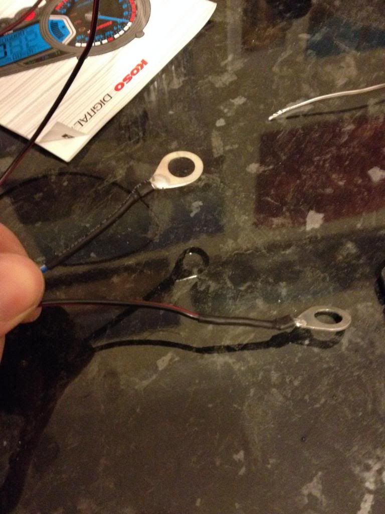

This afternoon I cracked on and connected up the positive and earth for the clocks, then begrudgingly used one of the parallel connectors provided in the pack to connect up the ignition switch. Didn't take a photo as I don't want to shame the thread with those horrid red things.

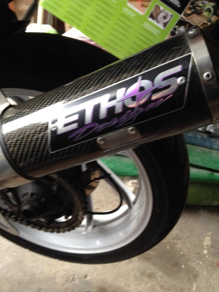

Watched some of the Winter Olympics, got bored and decided to finally re-badge my end can.
I put this little bugger in the way a while ago, so off it came.
The holes were then covered up by the Ethos badge.

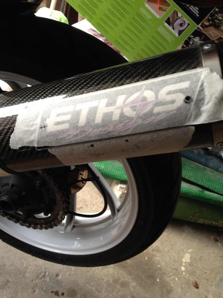

All masked and marked for drilling to rivet.
And finally all riveted into place, looks miles better.
