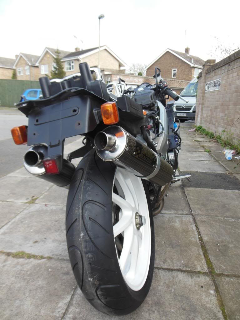

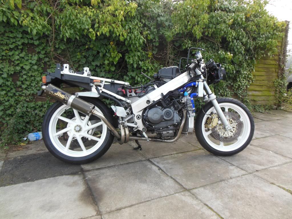

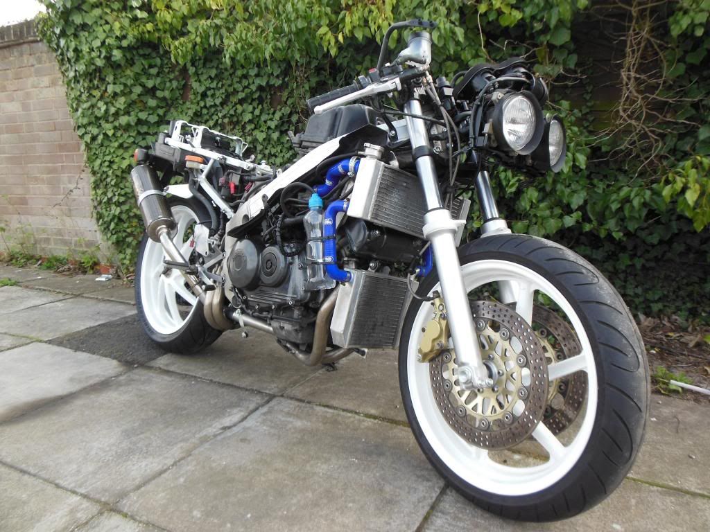

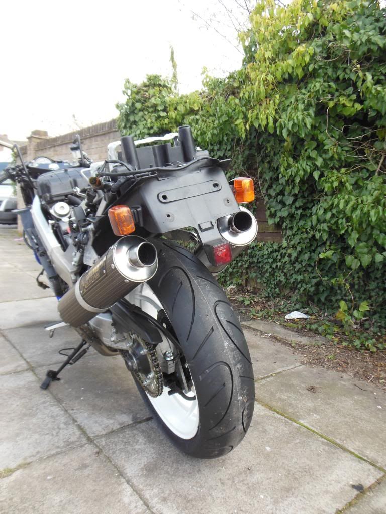

So i have got a few bits done on the bike over the last couple of weeks, fitted the C&S, bled the rear brake, sorted the water leak, fitted new pads, fitted new spark plugs and re solder the broken front coil wire plus a load of other little parts to just get it ready for the MOT.
Got the wheels back fitted the tyres and bearings today fitted them all and finally took it off the paddock stands for the first time and rolled it out into the sun for some photo's:
Jap spec clock will be replaced with a UK item that i got cheap off ebay the other day.
So there we are, now time to dress it in the patchwork plastics do one or two little bits and get it down for the MOT early next week, hope you all like the photo's.

Thanks Alex, yea its only to get it on the road, the RC30 seat unit doesnt fit too well with the original expansion bottle in place so i will be buying a HRC one soon as ive got a bit more cash, proper skint atm.
Must admit im not a fan of fancy rearsets, allways liked the originals over anything else if im honest, might try a set out one day though.

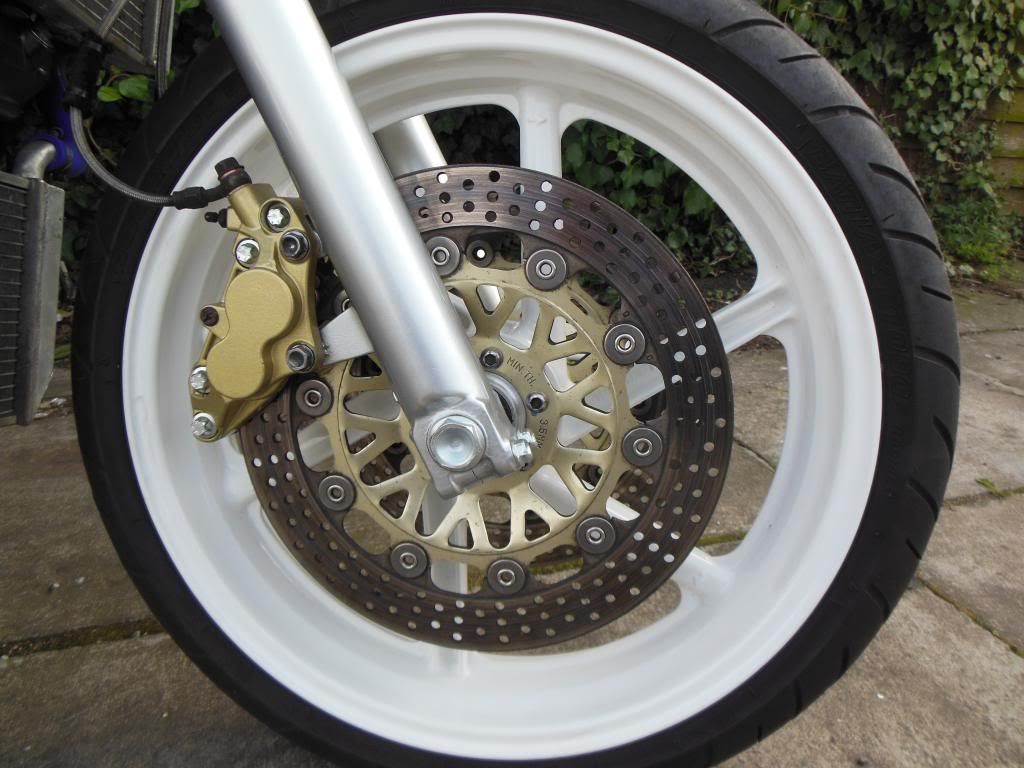

Just one thing, you need to push the forks up into the top yoke more so the forks circlips fit in the recess on the clip ons, should be about 2-3mm of fork showing out of the top yoke.

Thanks Kris, glad i went with the white wheels in the end reckon it goes with the kevlar better than gold would have.
Cheers for pointing that out mate, think i may have misplaced my circlips as i completly forgot about that
