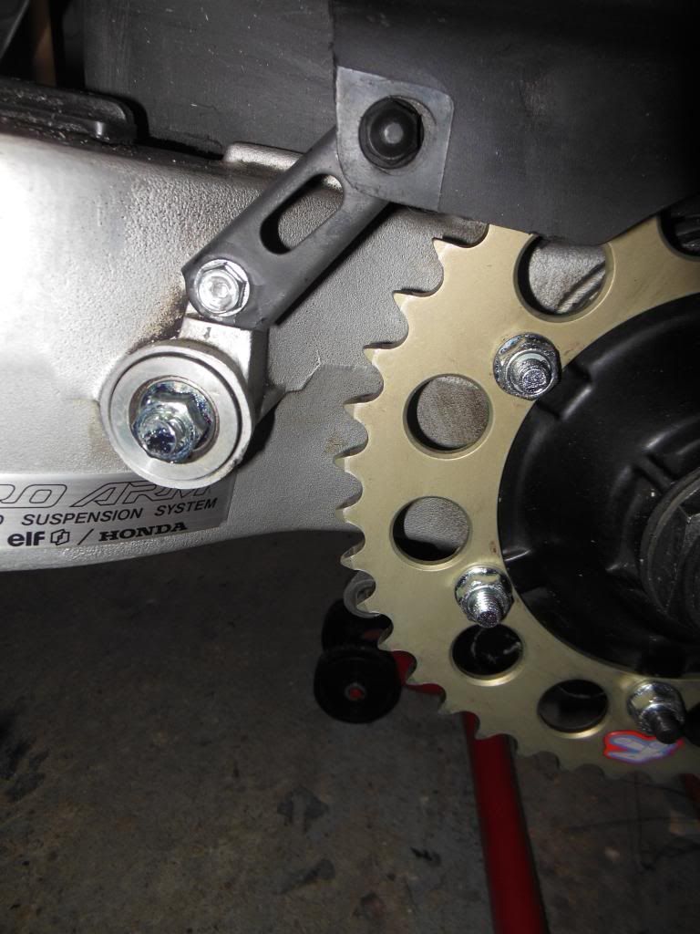

Some of the bolts fitted and the rear spricket routed the correct way round.

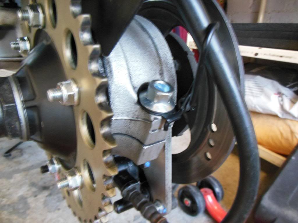

Completly forgot i sent off most of the caliper bolts to be plated so i fitted those, makes the mounting bolts look bloody terrible and stand out though!
