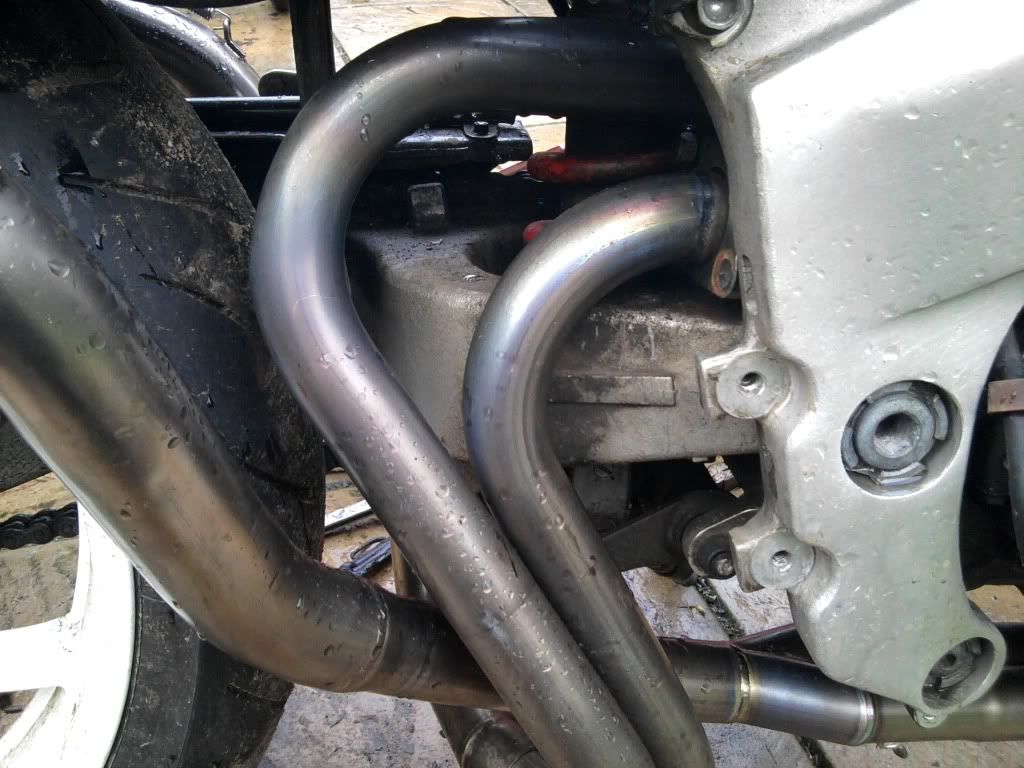

Rick O bits are here, so can crack on fitting the exhaust :)
loosely fitted up the rear pipes
And more or less how it will look when it's sorted (just minor tweaking to go now :)
