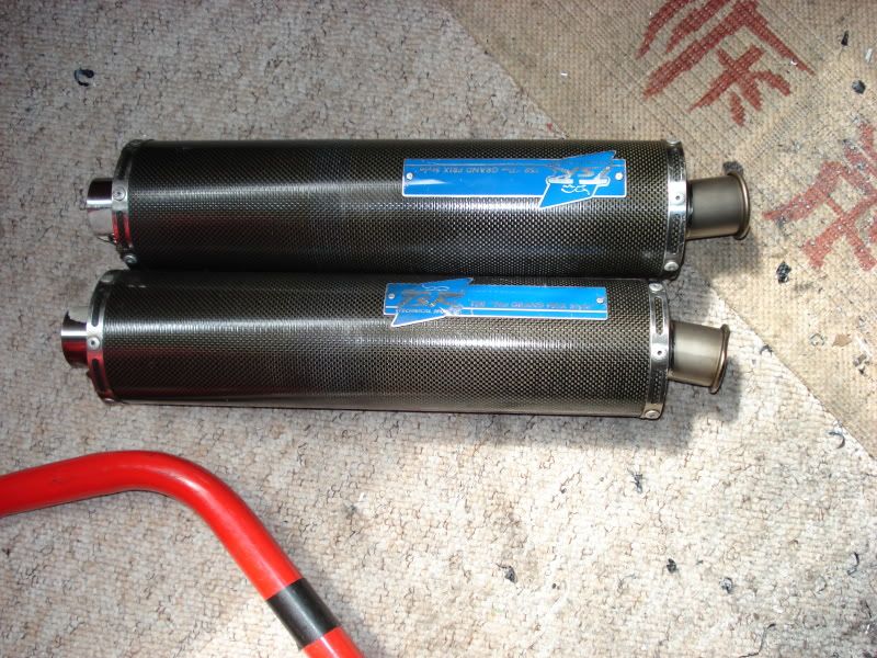

micpec wrote:Kris, this mail-pigeon just flew back 2 you.![]()
Fit it on one of your NC30's, try it out on a longer bike trip and remember to grab the Ti pipe section just afteryou have shut down the engine for let us say 2 minutes or so...
I will hesitantly try that!!

micpec wrote:Any updates, Kris?
Still waiting for the can straps from Gavin at the moment, also a few bits were needed from Dave silvers so i can get the forks back on.
I did get this though!!

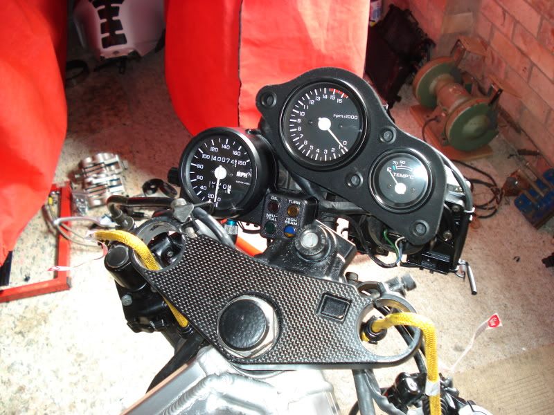

Right my second Project is underway! My 91' NC30 RC30 Replica.  I totally stripped it two weeks ago and started cleaning!! Jesus the amount of crap that builds up under the fairings is ridiculous!! I have gone through a acouple of litres of Gunk!! to get it semi respectable!!
It used to look like this!!
but now like this!!
So far ive managed to overhaul the brake system front and back, new pads, discs etc. Carbs have been removed, cleaned, rejetted 122's all round, needles raised and slides drilled. Front forks off and cleaned and polished they will be having new RO internals. Rear suspension linkage cleaned, greased and replaced, Hopefully new rear shock on the way!!.
Still got a few
  bits to put on including my TSR TI system and a Sillhouette Nosecone, and freshly podwercoated wheels and EBC discs
Its going to be sprayed in the OKI endurance Race colours too!!!
Some of you will notice that the wheels are the wrong colour but mine are going to be white until i can get my hands on some Dymags or PVM's!!
Kris
but now like this!!
Still got a few
Kris

Right a quick update, forks serviced, fitted, front wheel on, calipers, new pads, new braided hoses fitted.front down pipes on with new bolts, rads on and coolant in. Nice Coerce carbon front hugger on the way. Still waiting for the can straps to fit the ti exhaust. front panels including sillouette nosecone off to the sprayers, just waiting for the rvf seat unit from Gavin. Should be totally finished at the end of this month!! Pics to follow when i get time!!
Kris
						Kris
