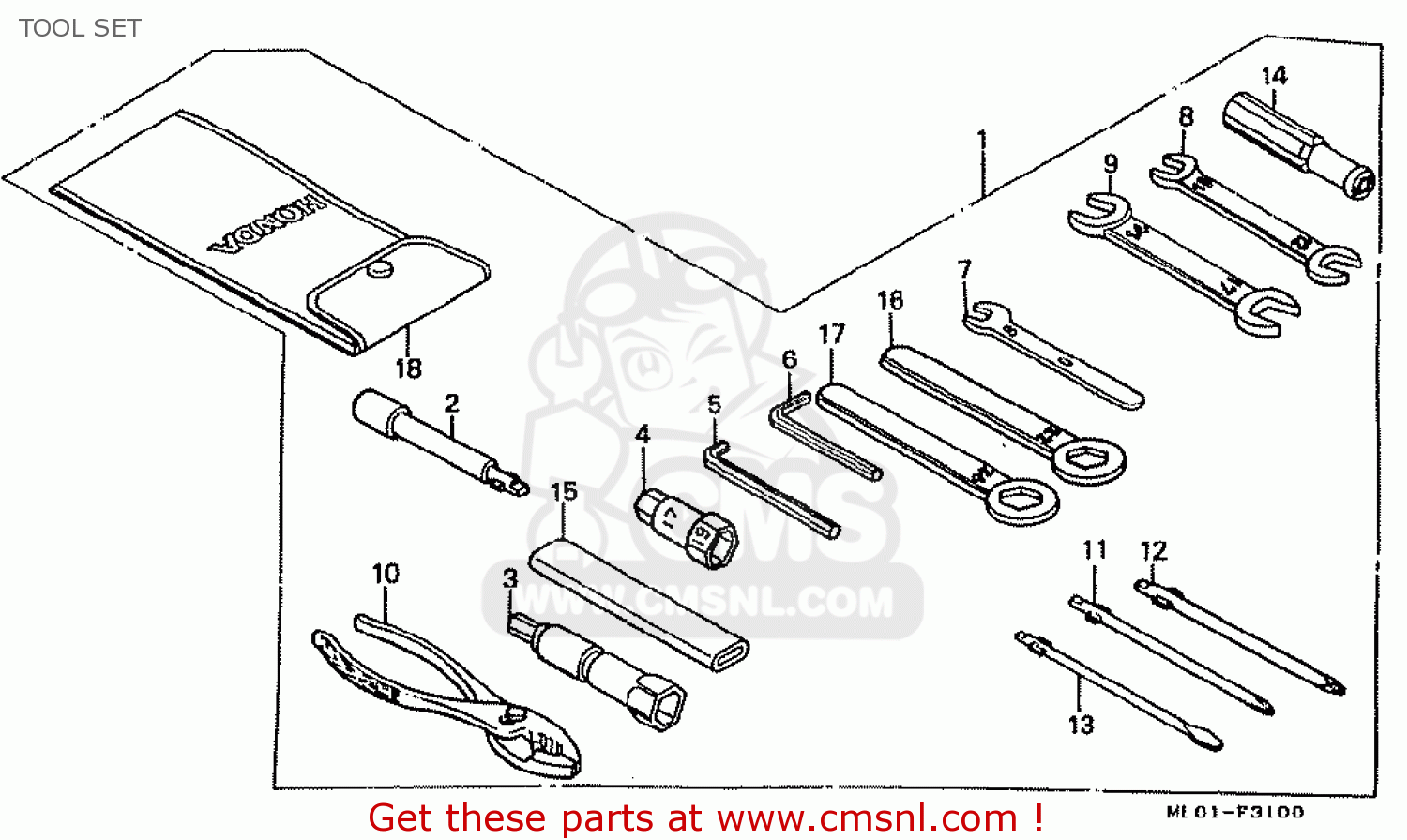

Oooh that is so cool... what's all in there Neo? I must restore!!!
Re: NC24 rough flat spot
Eben007 wrote:Oooh that is so cool... what's all in there Neo? I must restore!!!

Awesome thanks Neo, pity I won't have that little Honda branded toolbag... Sooo, I pulled the carbs apart yesterday, found 2 washers on the needles, adds up to about 1.5mm of richer. I took out both, so will see if this cures the midrange bog. Also there was ALOT of junk under the seat screens, and shes running 110/112 mains, which if I'm not mistaken is NC21 spec?
