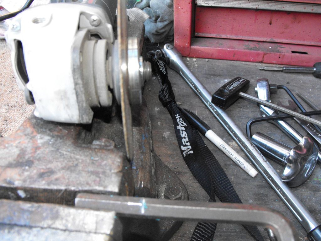

Not a hard job if you have the tackle.
As others have stated ; slacken top pinch bolts and cap but don't remove cap until you undo the cap screw in the
slider.
A rattle gun is a great help with a 8mm hex bit.( I cut down an old allen key as some 1/2" bits wont fit the recess.
A length of studding and some nuts locked together get you out of trouble if the valve block still spins with the rattle gun.

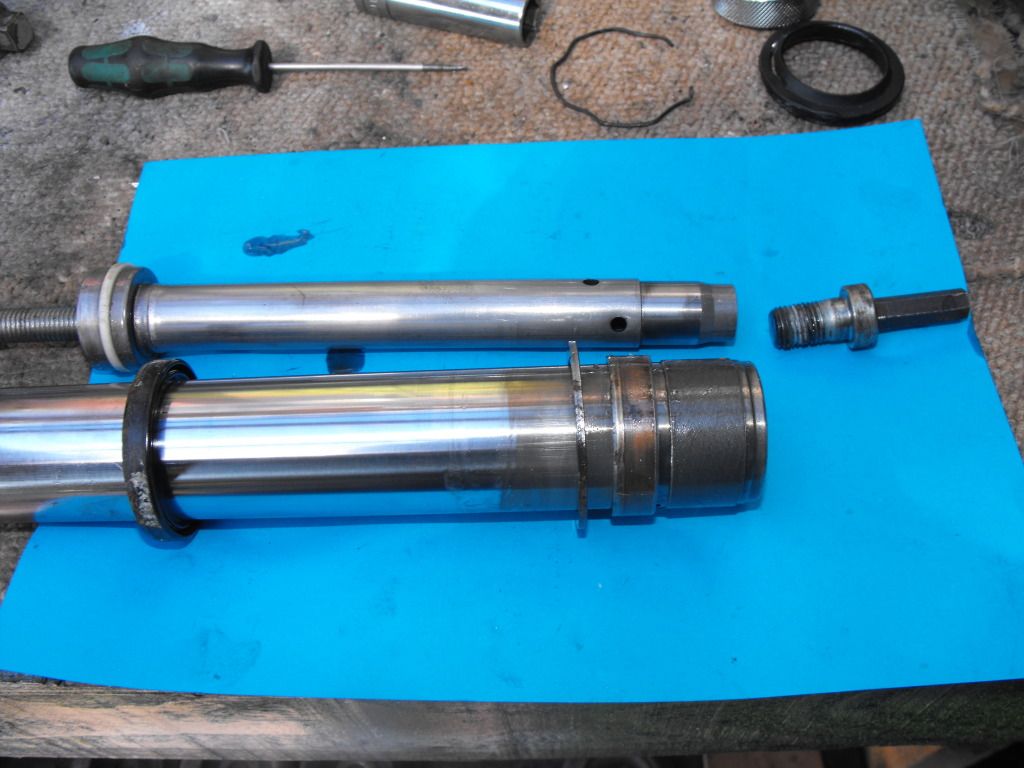

Re- anneal the copper washers for the bottom cap screws and wash inside the slider and valve with petrol after draining upsidedown. You will get loads of sludge out.
Lay everything out on the bench in order of dis -assembly.... there are a few different bits but it is a simple re-assemble job.
Use the stanchion as a slide hammer to remove the oil seal.
If it is corroded in.... use hot oil on the seal to soften/loosen it.
