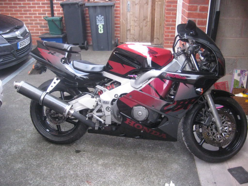

hopefully you guys can pick something out in the pics that im missing

Re: Cbr 400 NC29 Exhaust
You can always bend out the rear hanger mount a bit as well.
I just used various bushes I had lying around from my rebuild to alter the rear hanger to hold the can out slightly more than normal.
What happend to the end of the exhaust can bracket ? Its missing .
i think you might have solved it !!
As i have nothing to compare this to i had no idea someone else had previously cut the hanger down for the previous non standard exhaust.
looks like a good inch has been cut off, so hopefully if i replace the hanger i can get this to all line up
Thanks alot guys
