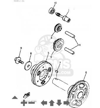

hi evil took casing of this aft bearing still in situ,i can see how shaft for starter motor fits in it,and have relocated it into engine,,the other cog to the right of it came off when i took the casing off ,along with said shaft,it dosen,t appear to have anything holding it on, unless it stays put when casing goes back on ,is it free floating so to speak? ,i also got both dowels out without breaking them so thankyou for your patience with me and your help always very much appreciated,regards mark.

The intermediate gears (2 and 3 ) locate on shafts (4) that fit into the crankcase and the starter cover.
The bearing (10) is identical on all models.
Do not force the cover on at refit. sometimes it takes a little jiggling of gears and case.
It is not unknown for the starter shaft (1) to be forced into the motor damaging it.
Ensure the bearing is seated fully home in the new casing or the casing wont seal and gears will bind.
If it has suffered damage sever enough to totally destroy the casing;ensure no debris has invaded the crankcases.
Tales are legion of racers who remove engine sump plate to check this after high speed spills force gravel into the crank.

that diagram is brilliant,number 2 gear is the loose fit one on mine it just seems to sit on shaft and looking at diagram there dosen,t seem to be anything holding it on which is how mine is so that all looks good thankyou once again and a happy new year to you regards mark.

Youre looking from the engine in that diagram, the casing supports the dowels and houses the bearing.
