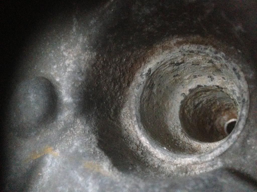

Got some work done tonight. Rads are off! The top rad is pretty much screwed, can probably salvage the bottom one.

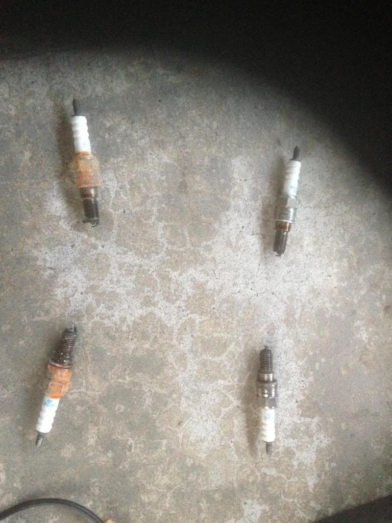

The downer of the night was pulling the plugs out:
Both left front and rear plugs were disgusting. All plugs were coated in oil. Going to order new plugs. In the meantime, what's the best way to clean out the heads without getting crap in the cylinders?
Re: NC35 Project Bike: Going to be a long few months!
Not sure, probably the small size of the plug is the biggest factor. No fix, but once you become more familiar with the bike and how it likes to be started (full choke when cold, no throttle) there's very little chance of flooding it. The plugs are expensive (about $25 each) so it's a lesson learned quickly for most people that flood them!SteveNC35 wrote:Out of curiosity, what causes them to flood easily and is there a fix or just have to put up with it?
I guess it's just cosmetic, but if you want to clean it up nicely then removing the rocker cover and using a wire brush then metal polish would be effective, or for a good-as-new finish you could get it soda blasted. (The rocker cover gaskets are rubber and can be reused by the way).SteveNC35 wrote:In the meantime, what's the best way to clean out the heads without getting crap in the cylinders?
Some good pics of engine cleaning and polishing results in Gimly's CBR400 rebulid thread: viewtopic.php?f=69&t=38123&p=285220&hil ... ed#p285220
A good comparo of soda blasting results in this thread: viewtopic.php?f=10&t=39817&p=291979&hil ... ng#p291979
Could just be the pics but your radiators actually look pretty decent to me, I've seen some in far worse condition but they still held a decent temp.

Were the badly corroded plugs on the left hand side of the bike? I'm assuming the RVF400 has a left hand side stand as well...in which case that would make sense as any water and muck would run into the left hand side of the head...just a guess. My plugs were worse then that by the way and my bike started after a little TLC, so don't worry too much. These Hondas are unbelievably resilient.
I googled 'Soda Blasting' and it's very easy to do. All you really need is a compressor and some baking soda. The Baking Soda is totally water soluble and so it doesn't matter if it gets into any unwanted orifices. Of course the best way to clean up the heads would be by removing them and cleaning them properly.....it's your project though mate, so every step you take is up to you! That's the best part!!!!
Yeah good point. It would also be worth checking that the spark plug drain holes are free to drain with all that corrosion around.Gimly56 wrote: Were the badly corroded plugs on the left hand side of the bike? I'm assuming the RVF400 has a left hand side stand as well...in which case that would make sense as any water and muck would run into the left hand side of the head...just a guess.

Yeah, all the corrosion was indeed on the left-hand side. The actual plug covers didn't seal properly either. And the top rad needs replacing as one of the brackets has been sheered off in the photo.
