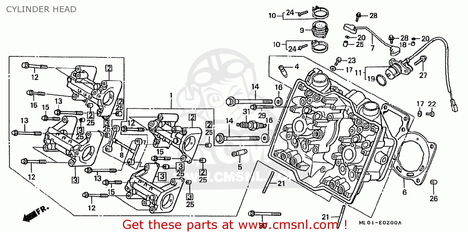

I didn't know that any of these NC13E engines used a position sensor, could be useful if it can be retrofitted to the later engines for the peeps doing EFI conversions.
Re: NC21 EARLY AND LATE ENGINES CAN THEY BE SWOPED
http://images.cmsnl.com/img/partslists/ ... 2_20ed.gifCammo wrote:I didn't know that any of these NC13E engines used a position sensor, could be useful if it can be retrofitted to the later engines for the peeps doing EFI conversions.
You can see it on this fiche.
Thanks Neo, I guess being cast into the head it can't be retrofitted to '30 engines.
Could be valuable for an injected 21 or 24 though...
