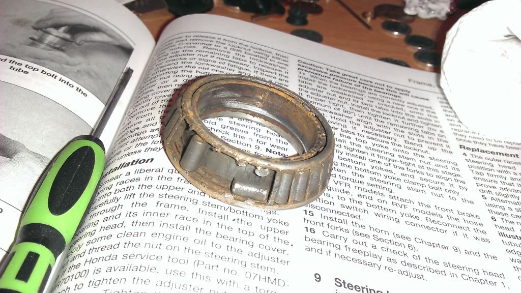

well, my bike make a clicking noise every time i moved the steering left or right, i thought it was just some of the cables moving about with the steering. then obviously things got worse.... and worse.. to the point that the steering would no longer turn... or turn by itself from the vibrations of the road when riding. so i stripped everything and checked my races... now where that picture...
aah here it is.
soo yeah. its not hard to do with a hayens, and its worth doing... the whole steering not turning properly and moving about by itself happened when i was actually on the road...almost died.

Alex its worth noting that OE ball race bearings are easier to fit so for the few extra quid there worth buying over the taper bearings. Even with freezing the stem and heating of the bearings you still need to drift the bearing into place and with the OE bearing you can remove the inner race so you can drift it on without risk of damaging the bearings, with the tapers you can't and therefore risk damage.

I'll say it again, DO NOT TORQUE TAPER HEADRACE BEARINGS! Just nip them up to take out the play, any kind of torque will crush them. The torque settings in the manual are for OE ball race bearings.
Ricky, id say if you've already torqued the taper bearing up then its goosed, replace it.
