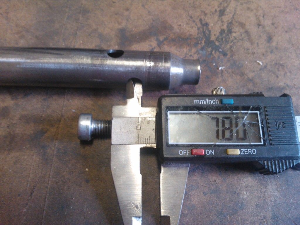

Drunkn Munky wrote:Send me a pic mate, if there the same as what i have here you can have em.
ill try pop them out, ive just rebuilt the fuckers so i hope i can slide them out the stansion without disturbing the new seals ive fitted, ill gaffa the stansions to the lowers ;)

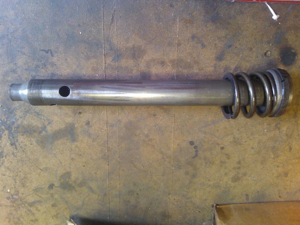

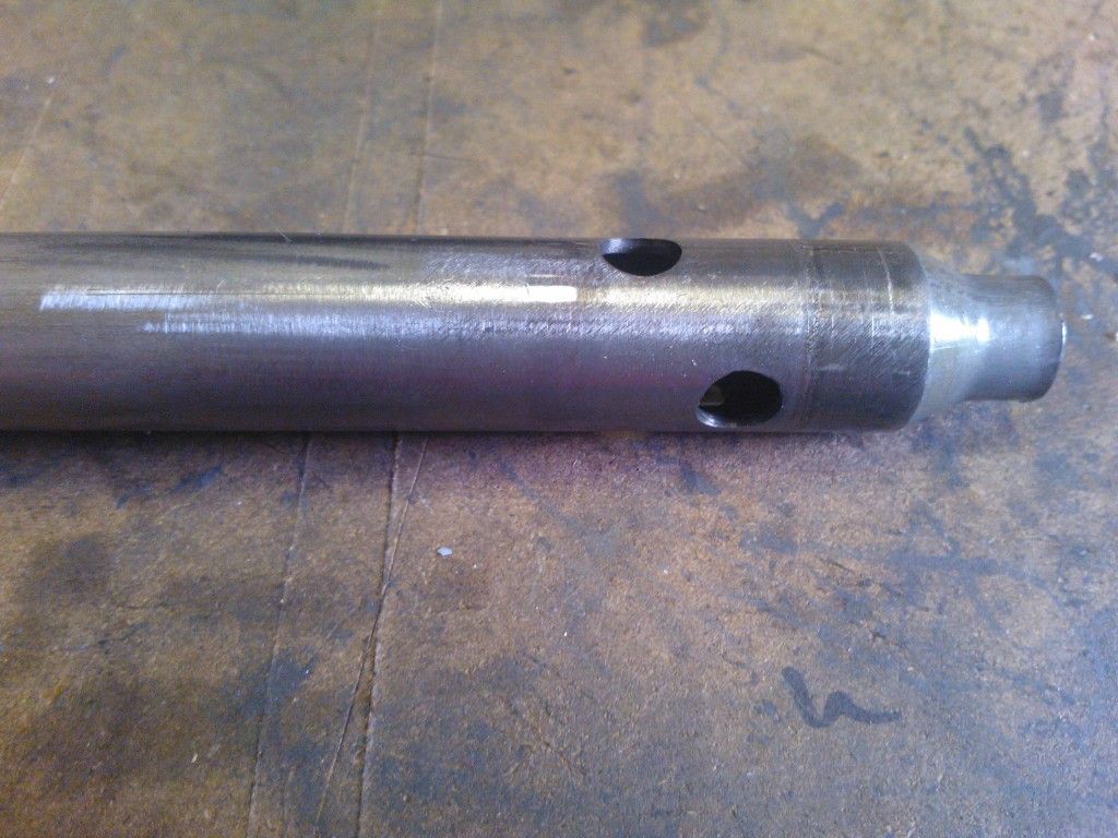

Drunkn Munky wrote:What does drilling them out do?
In my case, I drilled them to about 10mm to effectively allow zero damping! A valve emulator now sits on top of the damping rod which controls comp damping. :)
