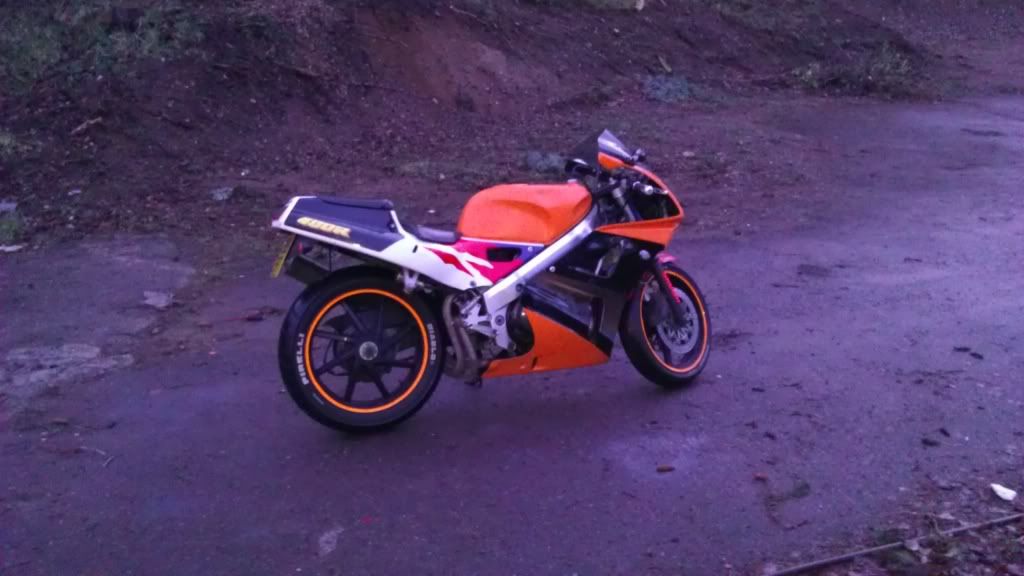

if i built my bike and it ended up looking like that id be happy (Riley i mean yours) lol my bike self painted with cans.. mind you lots of them and a lot of sandpaper

i noticed it looks a bit speckely.. its light rain i just couldnt wait to take pictures lol
and xivila take your time with it it will come right, it looks rushed and baddly prep'd slow down

yea its nuts i love the front end feel you get from it, and they look brill, the stopping power is unreall. some parts from you iirc. It was originaly a mod just for looks but man im pleased with it, the ducati fronter is not a new mod its been part of my bike for a good year or so now at least. this pic is oft a refresh, new disc's and new faring and because i cant ride it at the mo what else is ther to do but take pics and fiddle (with the bike)

haha true dat my friend, i have noticed i have rushed it. it will be better soon. i am currently in the middle of priming my tail section and i have to say, ive taken my time with it and its already starting to look much much better than my front and sides... i think i will redo my front and sides. i can still see some sand paper scratches on them which isnt very nice. it will be better soonBill wrote:i noticed it looks a bit speckely.. its light rain i just couldnt wait to take pictures lol

cool, it takes practice (or beer) being patient, i know if my old man wasnt such a profectionist and made me wait and sand and paint and sand .. and so on i'd have 'finished' it ages ago and it would have looked rubbish, lol i like the orange and black, i like the yellow aswell tho :D.. i just want to ride!

hehe yeah, i just sanded second coat of primer, and its silky smooth, just did a light gloss black on the side part of the tail unit. and waiting for it to dry and then gonna sand it. what shall i sand it with? i have a 320p "after coat sand" or i have the more extreme 1200p and 2000p wet and dry... ?

that 320 might be alright is it a wet and dry? i used mostly a 600 wet and dry and i used it always wet, (sounds insane) but if you listen to it while you sand you'll hear when it needs wipeing down (sponge and water) and the paper needs a 'wet' go's from sounding smooth to almost a bit gritty if you hear the gritty sound stop and wipe it down, with water and sponge and give the paper a swish, i used a 1000 grit wet and dry for the final sand before the top coat, again wet, but apart from the sanding side of it all i found the main problem with it was dust, no matter how much you sand and faff with it i always got bits in it, think it was like static or something, i used a cloth and a leather thing to wipe it down once dry to try and remove the dust, befroe painting but after sanding, that make sence? lol but all that might be a bit over kill!
