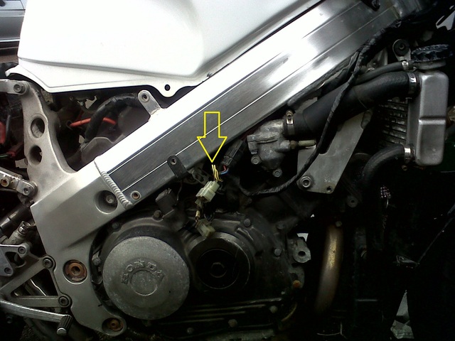

Re: VFR400 nc30 regulator rectifier problem??
hi i took a picture of what i think are the cables just double checking with you guys first?
That's the one.
