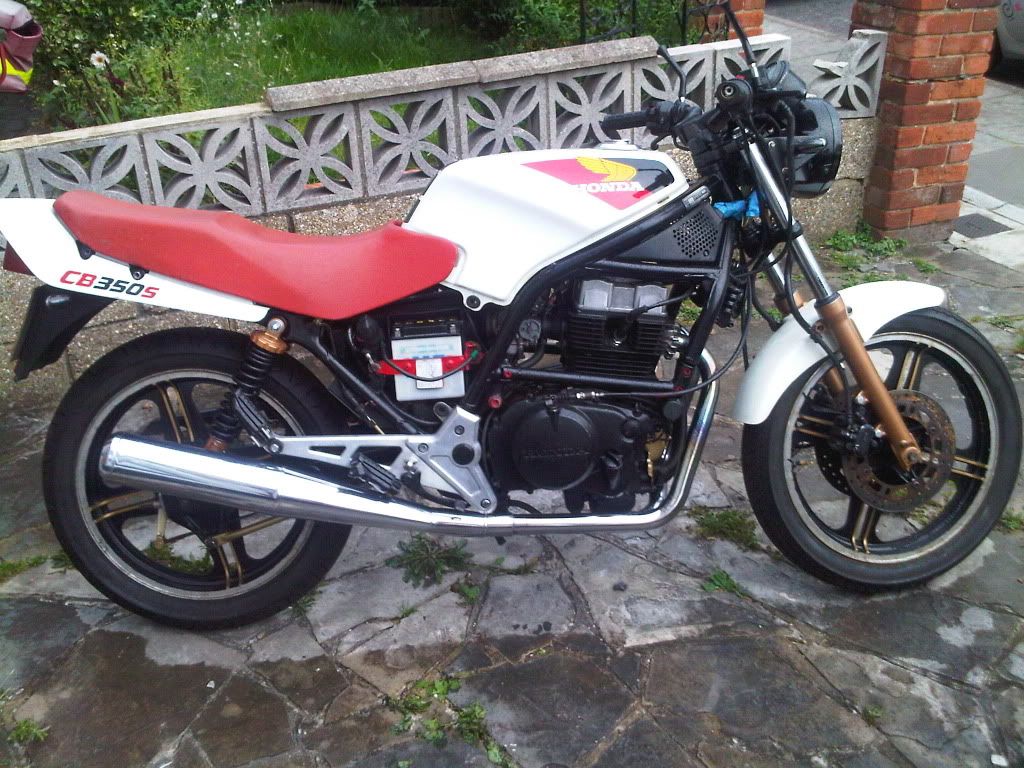

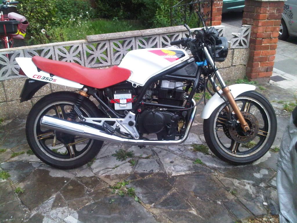

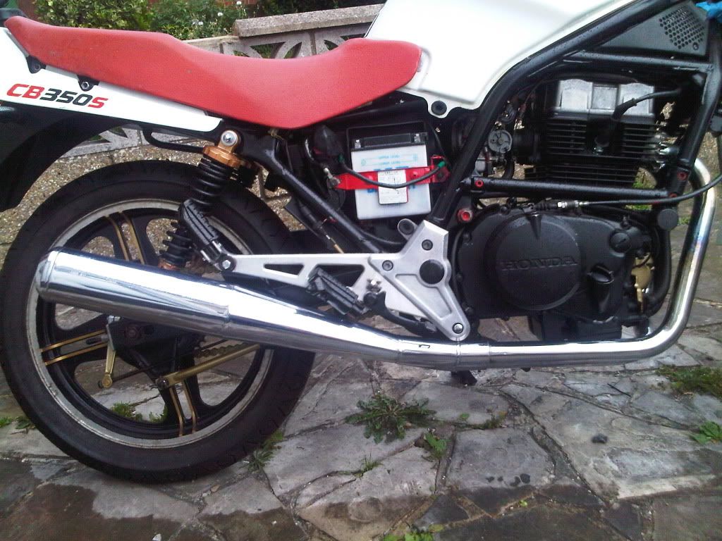

exhaust system turned up this afternoon, so couldnt resist whacking it on, i thought it was an original when i purchased it on-line lol its a motad system, for the dollor its like new :) 80 quid and happy. fking hard work finding any second hand parts for this bike! a few pics.....
i will stick an MOT on her, few wireing problems need sorting first too but all small jobs. hope to get 500-600 for her. aparently the white ones are even rarer than the black.
