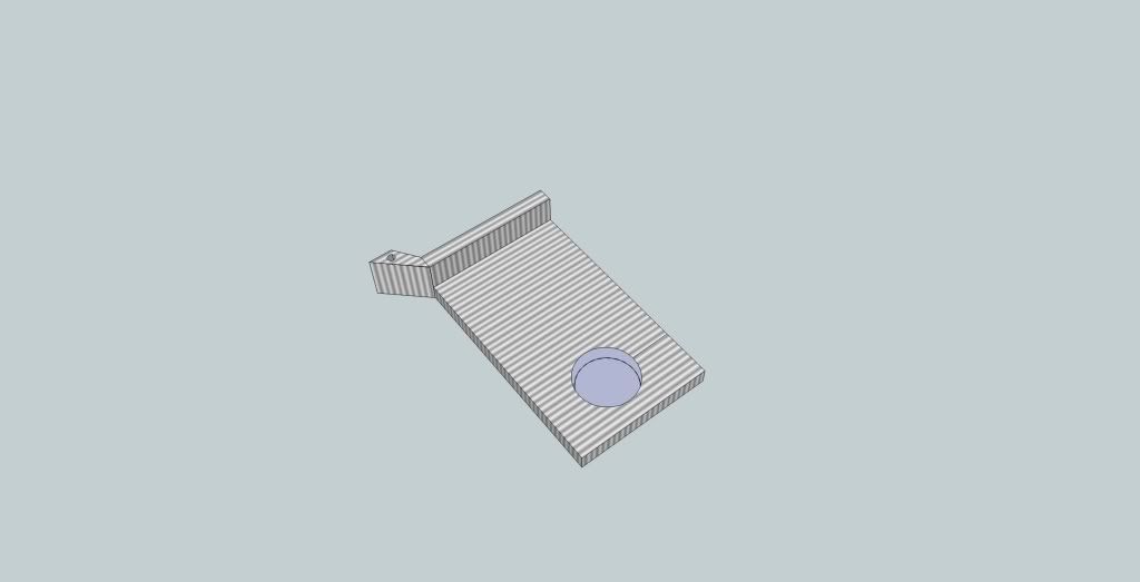

I think you have the same idea I had for making a better clocks bracket. Potentially much tidier than how mine is but as you say, no good with a welded yoke! I was thinking I might use the funds from selling you a pair of yokes to get an unmodified early yoke, and make basically what you are talking about. It's annoying that I can't use the unmodded yoke I have, but it looks awful with the flat-bottomed risers overhanging the curved surface. Fine with single bolt fitting risers, but then they're no good for me...
here is what I think
http://i1193.photobucket.com/albums/aa3 ... nal2d2.jpg
The idea is to secure it under the yoke so that the top part of it looks nice and clean. I dont know if it is possible though. Otherwise
simply by reversing it
http://s1193.photobucket.com/albums/aa3 ... seview.jpg
It can fit on top and become the right hand bracket.
Of course the dimensions are random.

We are on the same idea with the brackets, yes.
