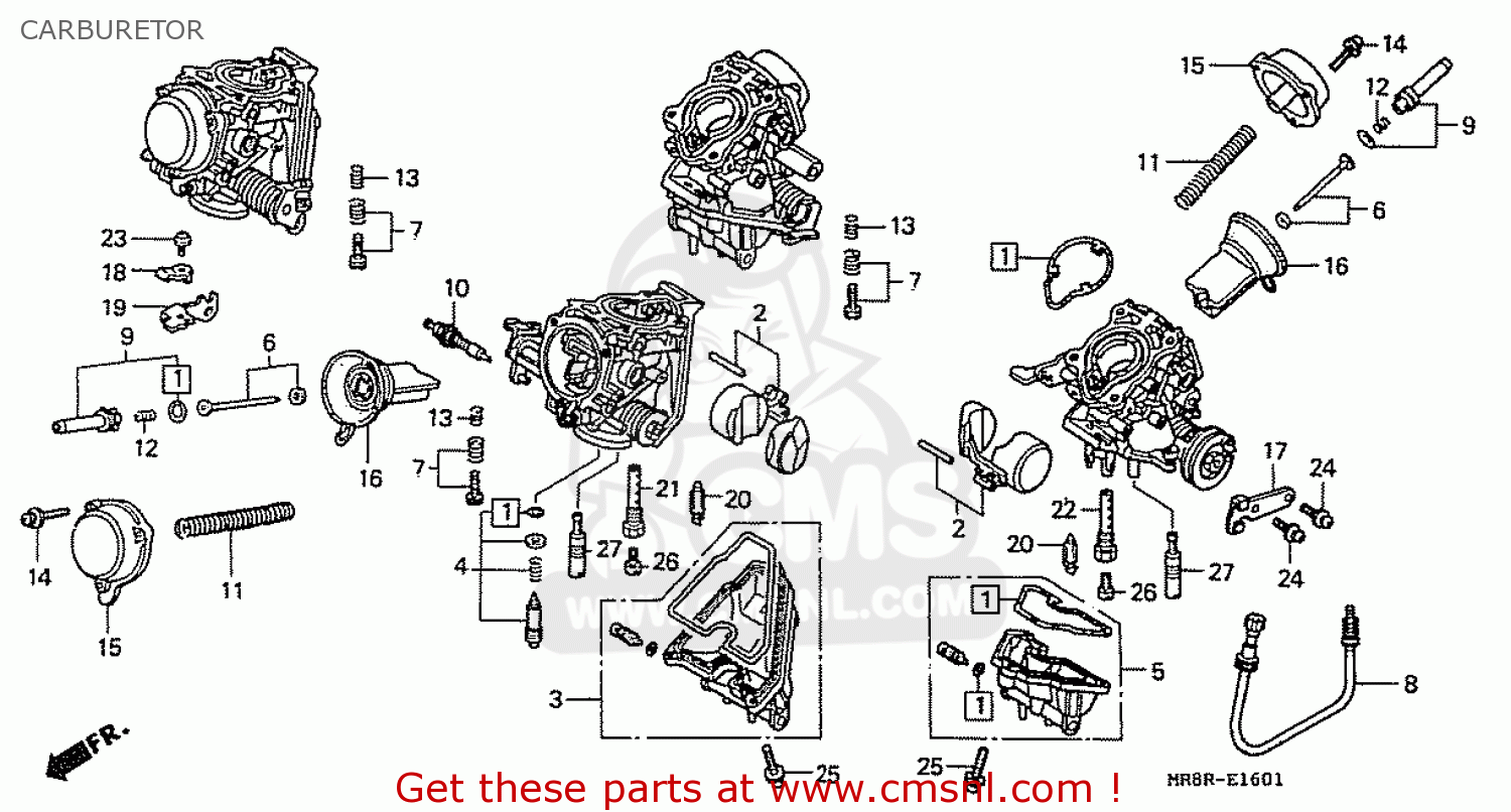

Re: Bike no low end?
The float height is adjustable
12.5mm for the NC35
The needles come out pretty easy
http://images.cmsnl.com/img/partslists/ ... 1_0e3f.gif
Have a look there for a microfiche so you can see how they come apart
12.5mm for the NC35
