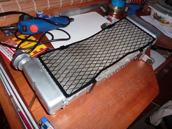

As I mentioned in an earlier post as you all know, if everything is equally covered in grease, shit and dirt then the overall impression is at least uniform. When you clean up one bit then put it back on it makes everything else look worse. Hence the radiators. After 20 years of abuse and mistreatment they looked like this.
At this point I realised why I was running a leeeetle bit hot last summer...
Wirebrush, degrease, lots of masking and lots of working through EVERY fin with a sewing needle and compressed air keyboard cleaner. Ill post up the finished items later.

Chapter 2. DONE!
So after much poking and prodding with a variety of implements (the sewing needle and zip tie being the best if you're asking) the rads are about as clear as they are going to get. Masked, primed, and sprayed top rad back to silver and decided to go with black for the stoneguard as I though it would look cool (I think I was right) and the lower one with matt black VHT paint. Fan and mount wirebrushed, Kurusted, degreased, masked, primed and painted with more black gloss enamel. Lovely job. All in all I am pretty pleased with them especially the upper one considering what they looked like before. Hopefully this will translate into cooler running as well!

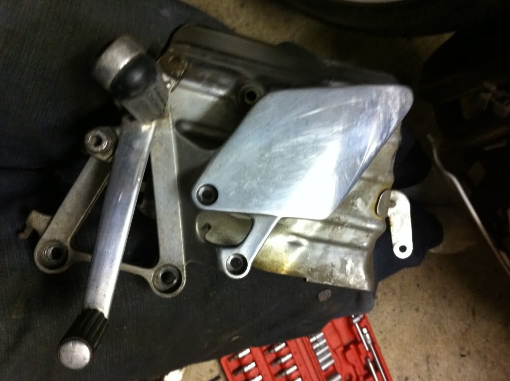

Next thing was on to the rearsets. I had read a few bits and pieces about restoring them and decided that the less invasive and abrasive the better on these as the finish underneath all the crap was still pretty good. (Gotta love Honda engineering and finish quality from this era)
Before:

Degrease. 00 Wire Wool. Autosol. Elbow Grease. Polishing mop. Buff. Repeat.
Blue Peter: Here's one I prepared earlier.
The quality of the photos doesn't do them justice really but for ease of uploading direct to photobucket I am shooting on my iPhone and they aren't too bad.
