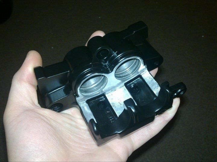

More Pics of last fews weeks work,
DIY - K&N
Piper X Breather
Valve Clearance Check - Rear
Front Brake Resovoir, W&D and then Lacquered
Rear Caliper Overhaul
Seized Pistons Before
Polished Pistons After (Condensation!)
New Seals
Job Jobbed
DIY - K&N
Piper X Breather
New Seals
Job Jobbed
