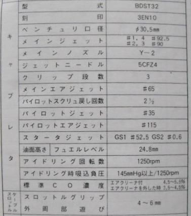

Excerpt from 3EN2 factory manual; I am unsure if the bottom section with 4 ~6 mm data even refers to carburation
( the rest of the carb info is all contained in the one "block" above it !!)
Oh the joys of import manuals
EDIT: After x reference (for Japanese description) using the SP 2TK manual;
The recommended fuel level is 24.8 mm

- Posts: 983
Re: 3en2 Needle help.
Needle clip is middle groove of 5 =3.
Are your carbs like the pic posted by Evilchicken0 in the link ;previously discussed fuel levels.?
Those are 3en2 carbs;the line can be clearly seen.

- Posts: 983
I went out to the garage and inspected some scrap 3en2 carbs .
They to have no line on the bowls;
The figure must relate to float height.
Something is physically preventing the butterflies from closing fully.
The only other scenario is the that the carb to head rubbers have severe leaks but the revs wound hang before dropping to 2/3 k.
