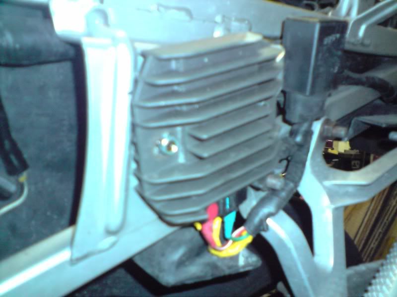

Morespeedvicar wrote:Heres a pic of my 2000 R6 one, sorry about the quality there off me phone.
Ian
Did you solder all the connectors on? If you just crimp them there liable to get hot and melt away

Hiya, there crimped and soldered, and packed with vasaline to try and keep out water! Its, been on for 110 odd miles so far and is still charging ok.

i asked him and he said it was 5pin....wud be ok?

Hi, yeah as long as 5 pin it should be ok, you may need 2 normal size female spade connectors as well, as the honda ones are bigger than the yam connectors on the regulator.
