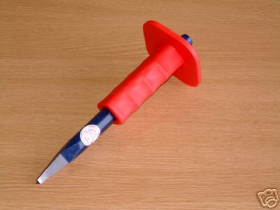

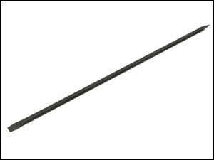

There's various ways of getting them out. I went to a mate who has a sort gripper-pulling tool. It consists of two arms with small hooks at the ends. They are adjustable in distance from each other to fit inside the headstock, just clamping the bearing from under. The tool had a thread and a nut at the other end to which he attached his adjustable spanner. While the gripper hooks held the bearing, my mate banged on the adjustable with a hammer. This way we got the headstock bearings out.

On the yoke sits another difficult one. That one was banged-out with something like a needle / point chisel.
or:
Be careful not to damage the yoke (your hands / the floor) while hammering away.
