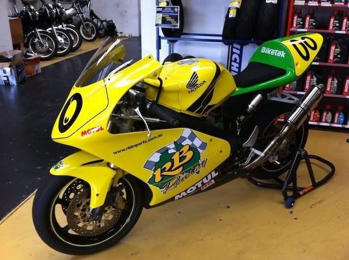

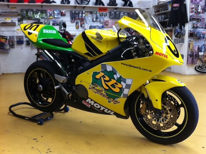

I've been thinking about fitting a Honda RS250 tail cowl to my track bike also, mainly to simplify access to the carbs. I was in Sydney last week and snapped a few pictures of Harley's NC35 at RB Racing. The fairings are all Tyga so is the subframe. I can't remember if it is from version I or II of their RC211V kit but I do know it took a bit of modification to accept the RS250 tail.  Very nice job:

Yeah nice (and infamous in Oz!) bike that is. It looks like a modified 2005+ honda rs250 (Pedrosa style) seat unit.JB wrote:I was in Sydney last week and snapped a few pictures of Harley's NC35 at RB Racing.
