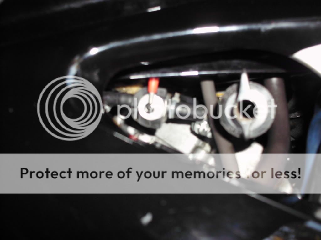

I bought a 1/4" ball valve off ebay, and a couple 90 degree connecters to route it just underneath my stock fuel tap.
Double's up as an anti theft... well sorta.

Re: Reliable on/off fuel tap for HRC setups
As Timoth said, fuel pumps only run until pressure is reached. Once the bowls fill up the float valves seal and the pump stops. When I turn my ignition on the pump runs for a few seconds then gives a little pulse about every 3 seconds which I put down to having slightly leaky float valves.
One note of caution: Modern FI bikes have a tilt switch that cuts the pump if the bike is on its side. Fuel pumps on nc30s won't have this so in a crash the carb bowls will piss out through the overflow and the pump will keep on pumping.
re the tap, I have the diaphragm removed, so no vaccum needed. I also discovered a while back that a previous owner had chopped out the internal filter completly. That means ON and RESERVE both take fuel from the bottom of the tank, i.e. no reserve. The bike has an inline filter instead and I'm guessing this was a race mod where running with low levels of fuel is useful.
