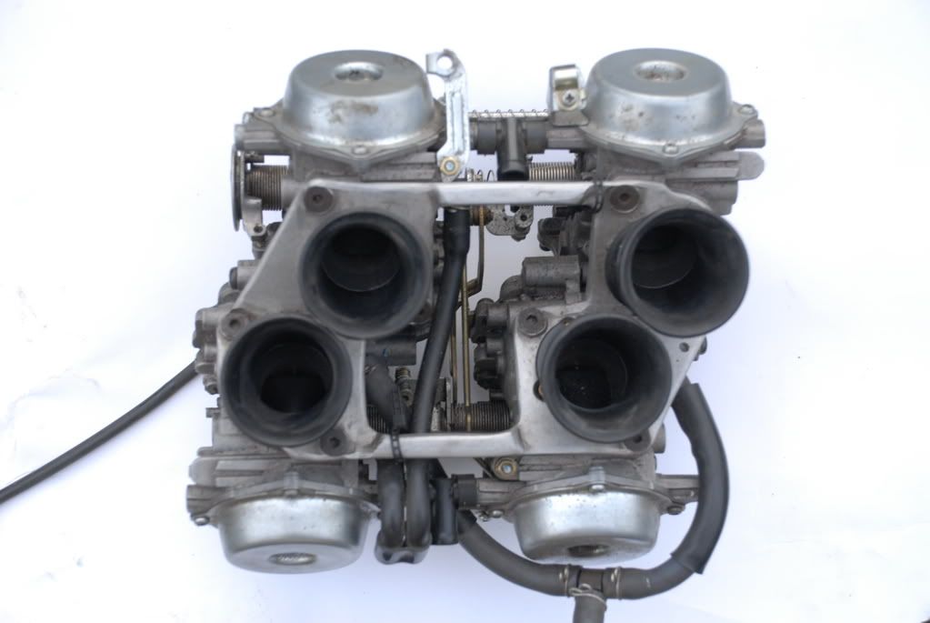

hunter
- Posts: 1292
Re: CMSMJ1 - race bike build thread
CMSMJ1.take a look at these tony scott built these along with a motor i got.
- Posts: 7166
They are pretty pukka looking carbs there Hunter. Mine have not had the grinding and chopping activity as yet. Been a busy mofo.

Spike16
- Posts: 1670
not chopping the subby? this is a race bike... go on man pull the finger (or grinder) out and get chopping!
ps bike looks great, o and whats special about the carbs? is it the minimalistic brackets?
- Posts: 7166
It will be chopped, just not yet! Main priority is to get this motor running and then go from there. I am not more than 50% sure that it will run OK as I have never heard it running and so if it is knackered then I need another motor and I have not got time or the strength to be honest with that!!
Carbs wise..if Mr Scott has had his V4 guru hands on them you can bet that there are more tweaks to them than the chopped carb tray. Saying that, the tray being chopped answered the question that we were asking in another thread. Was it for airflow or weight?
Weight I reckon...
